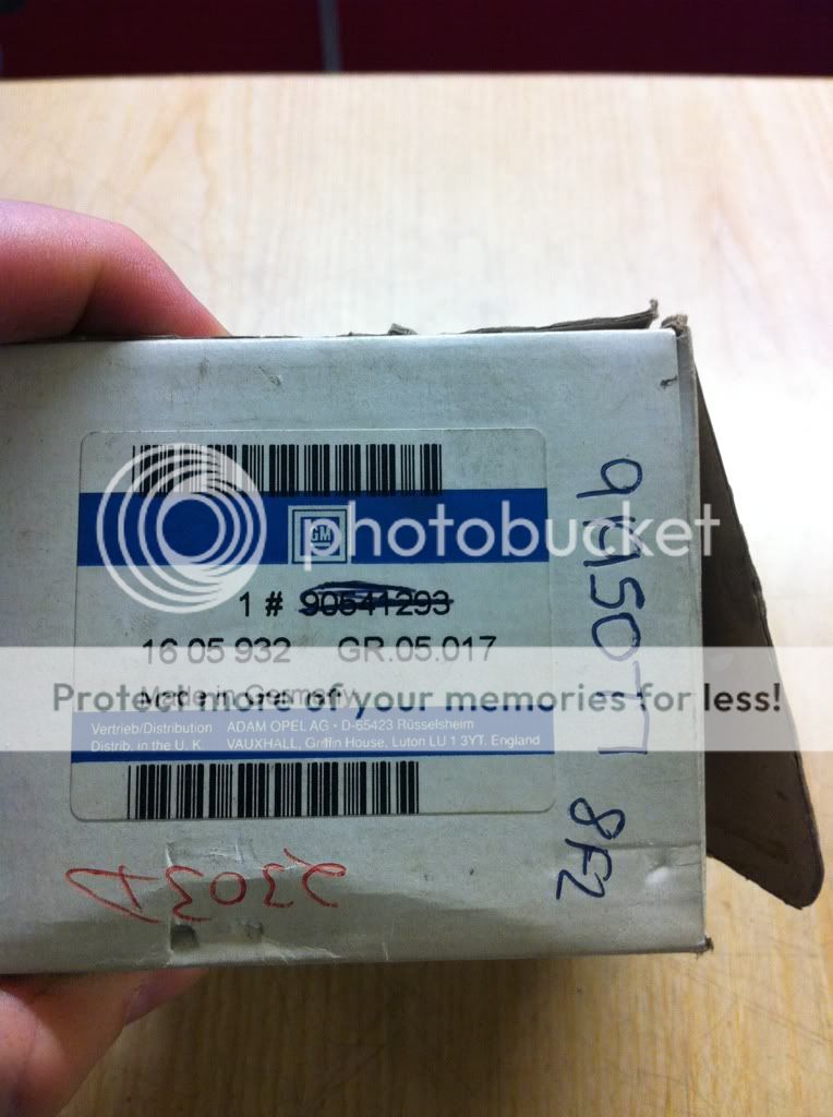

Right. Visited my dealer, who had both sets of oe in stock.
SMD, yours appear to be old stock. As pic below, you'll have to take my word for it but your pads are in the box pictured below.
Note the old style packaging with no hologram on the sticker, the old scrubbed out part number, with new part number written on the side. My dealer says they've had these on stock for years.
The oe pads with four shims are the new part that dupercedes the old ones pictured.
According to my dealer anyway. And the packaging would appear to support that theory. Hth

Re: FAO people with OE brake pads
« Reply #19 on: 10 April 2012, 17:11:22 »
I should add, the friction material on both types of oe would appear the be the same, visually speaking.

EPC implies old number for Carlton/Senny, new for Omega.  As they are compatible, new part can be retro fitted back to older cars.
Old PN not listed at all as a Omega-B part.

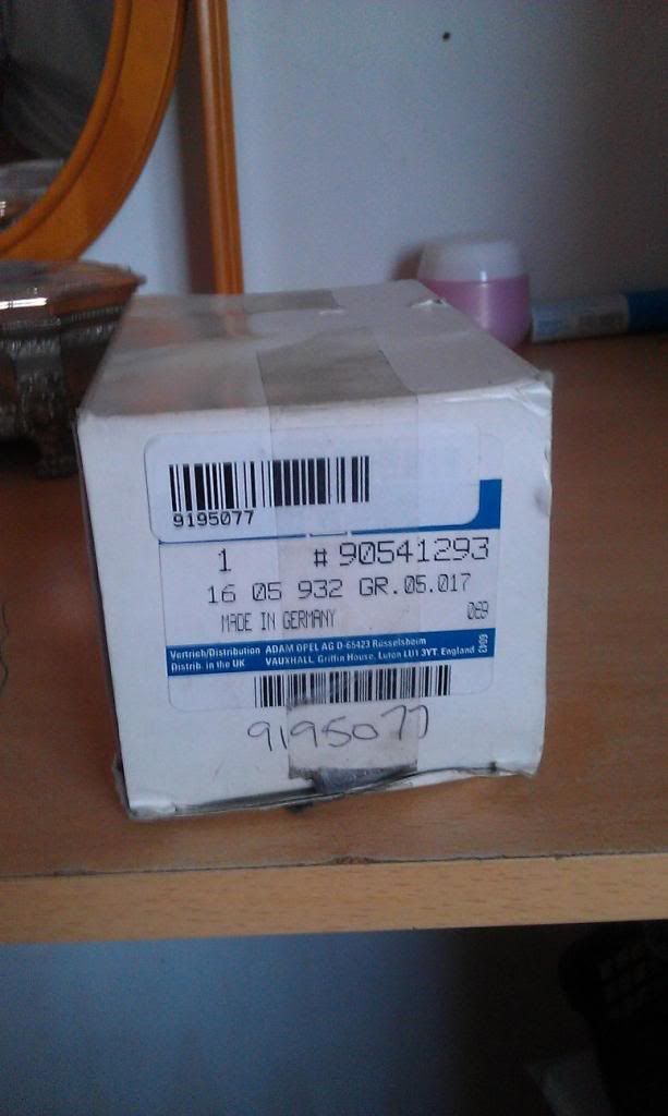

« Reply #23 on: 10 April 2012, 19:00:53 »
I made a mistake in my post above and cant seem to be able to edit. I meant to say Andy said he thinks the 4 shim set is old stock and the ones I have are the new stock.
Anyway, this is a picture of the box mine pads arrived in.
  • Posts: 108191
« Reply #24 on: 10 April 2012, 19:05:07 »
The printed number is what is in the box. This is an old part number. The handwritten number is the part number of the part that superceded the earlier part.  Based on EPC, I'd be thinking that GM are shipping out old stock?

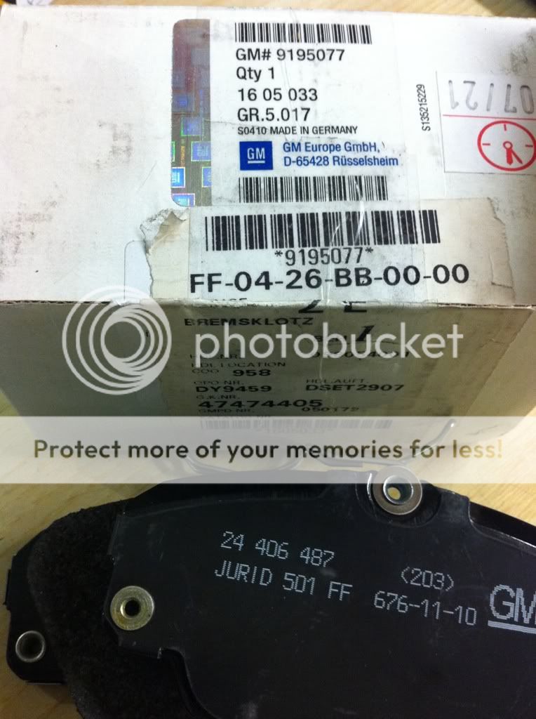

SMD, yes mate, sounds very similar to the conversation I had with Andy earlier today. It would seem he may have the old and new parts the wrong way round, in that your packaging with old no. on MUST be old (or at least older) stock.
To make things clearer, I purchased these today in the pic below, as Andy felt they would be hard to come by, I grabbed them while I could, at £80 odd
Note the label, more modern with hologram and no other part numbers on.
I visited the dealer personally, as I want oe as well. I inspected personally and took the pics myself there and then. (they think I'm mental by now I'm sure ;D ) I purchased the ones in the pic above. The ones with Shims on each. But I paid more than you did iirc going by previous pm's?
Tbh, I'd probably fit the ones you have and see how they go. Tc pads squeak, not oe. And of the do squeak/squeal, send the buggers back.
