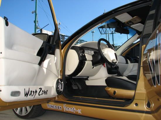

danzigfan
Nice and smooth surface  :y Planing to do something like this ?

;D ok then...
x25dt
Looks You've got a great interior there :y
Johnny English
Quote from: x25dt on 24 May 2012, 18:13:33
I like interior as well especially the family album... ;D great job anyway congrats matey!  :y  :y  :y

twiglet
Quote from: danzigfan on 24 May 2012, 16:31:01
That's just mental, but I like it!!  ;D  A huge amount of work has gone into that!!  :y
Johnny English
Supposedly the owner doesn't have any children, who would leave their own foot- or palm-prints either on the carpet or on the windscreen... :) anytime I make a clean the clearness never takes longer than some hours and my iron is full of prints everywhere... ;D
