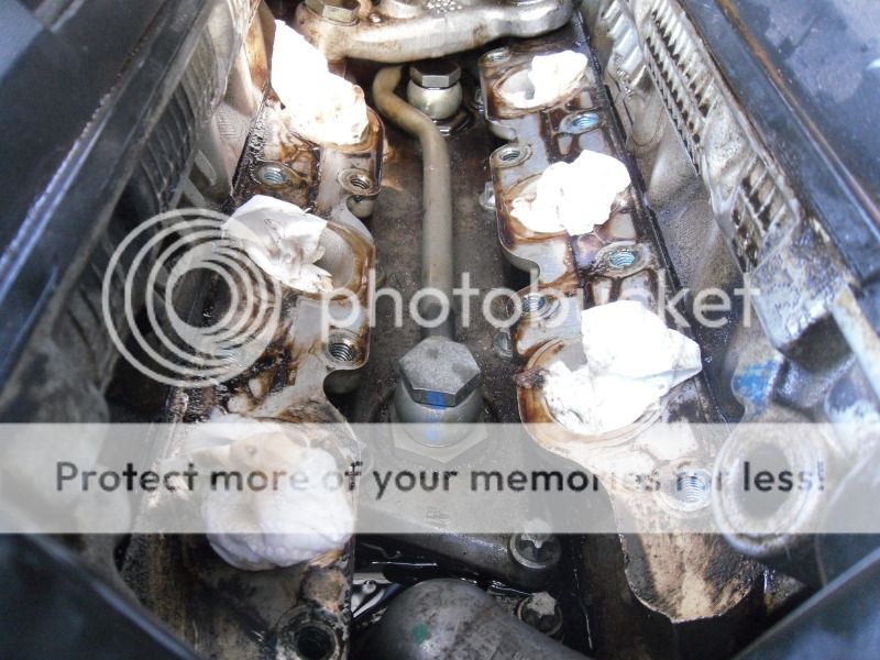

Sandwich plate off, now what am i looking for ?

Not clear from pic, is that rear banjo leaking oil?

« Reply #39 on: 22 September 2012, 10:54:02 »
possibly but there is oil in all the recesses  :-\

« Reply #40 on: 22 September 2012, 10:56:40 »
But no signs of water, plus had a good look at hbv and there are no water stains on it anywhere so pretty sure that is not leaking !

« Reply #41 on: 22 September 2012, 11:10:07 »
Something amiss with cooling at back, if demands for heat adjust the leak rate ;). Split hose likely if not hbv

« Reply #42 on: 22 September 2012, 11:14:43 »
Just about to say the left hand pipe on the coolant bridge seems wet and signs of spray behind the joint/pipe.  if  i remove coolant bridge and rear banjo bolt do i need new seals and what fluids will come out from where ?

« Reply #44 on: 22 September 2012, 11:51:00 »
Did the oil cooler job this year. If you remove the coolant bridge, coolant will leak out if there is still any in your system or if you have not drained it. It is recommended that you refit with new washers, 2 per banjo bolt to correct torque (info on the site). I guess you may have to remove it to properly check torque on the rear oil cooler bolt (if you think it is leaking). That much oil that high up, i'd be running my fingers around cam seals etc before doing an oil cooler job, especially if you did not experience oil in your coolant tank...anything can go at any time though. Decisions, decisions. Keep going!
