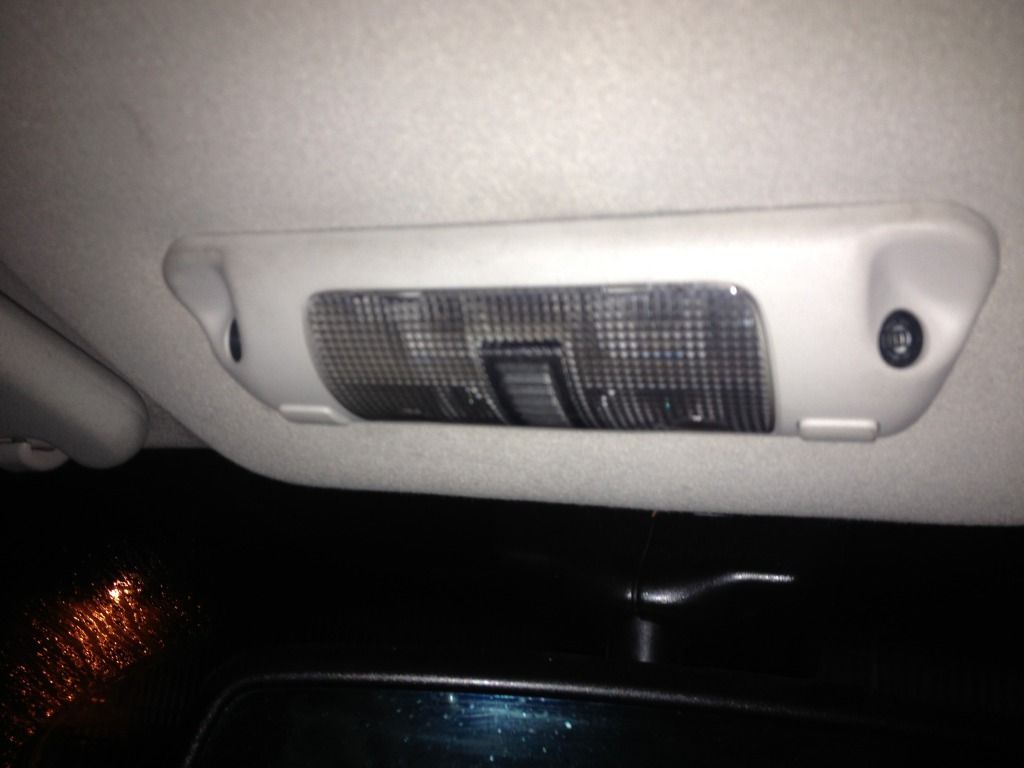

« Reply #6 on: 11 November 2012, 03:43:22 »
this is the original light that is fitted on this one i have nothing when i open the door or pull out the light switch and the map lights have never worked

  • Posts: 108322
Re: Wiring help
« Reply #7 on: 11 November 2012, 16:21:39 »
OK,
Ign 12v on black
12v on red
0v on brown
