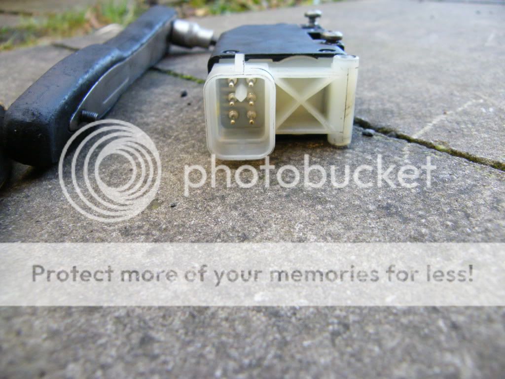

Re: Facelift door lock
« Reply #10 on: 08 December 2012, 21:58:39 »
It's a nice easy job and the motors are interchangable from passenger to drivers side ;)
My understanding is that they are different...
...from memory only the drivers door has six pins.
Thankyou Guys, all comments taken onboard  :y
Mike, thanks for the offer it is very much appreciated but at the moment Brikhead has provisionally sold me one.  :y
Thanks for the quick payment Phil, that's your item in the picture above! I'll make sure it's posted out first thing Monday.
