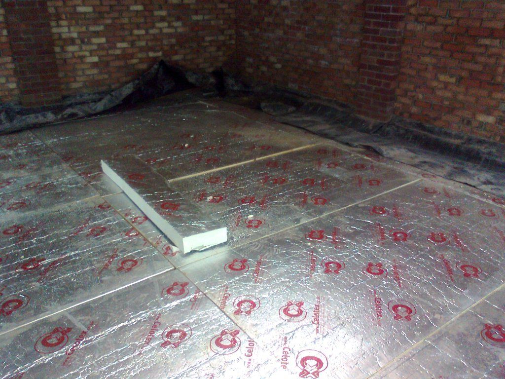

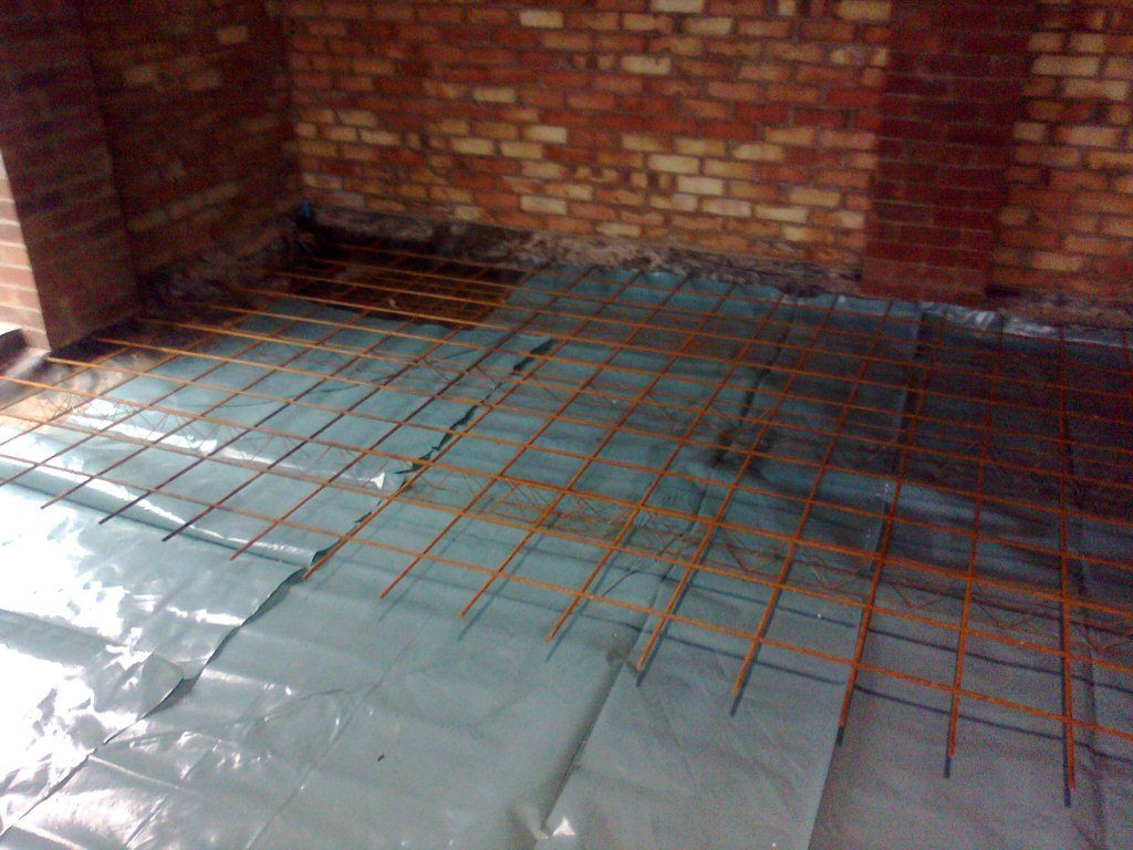

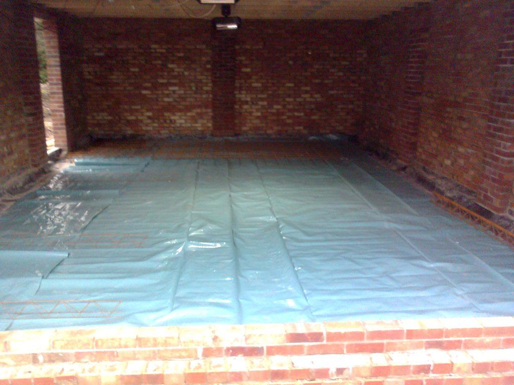

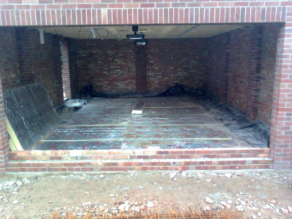

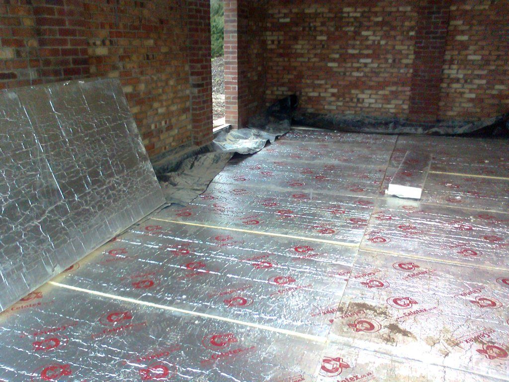

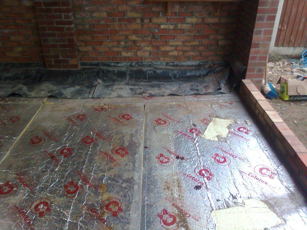

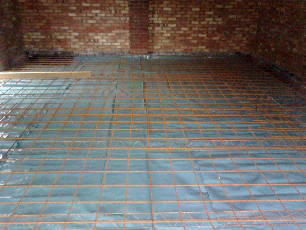

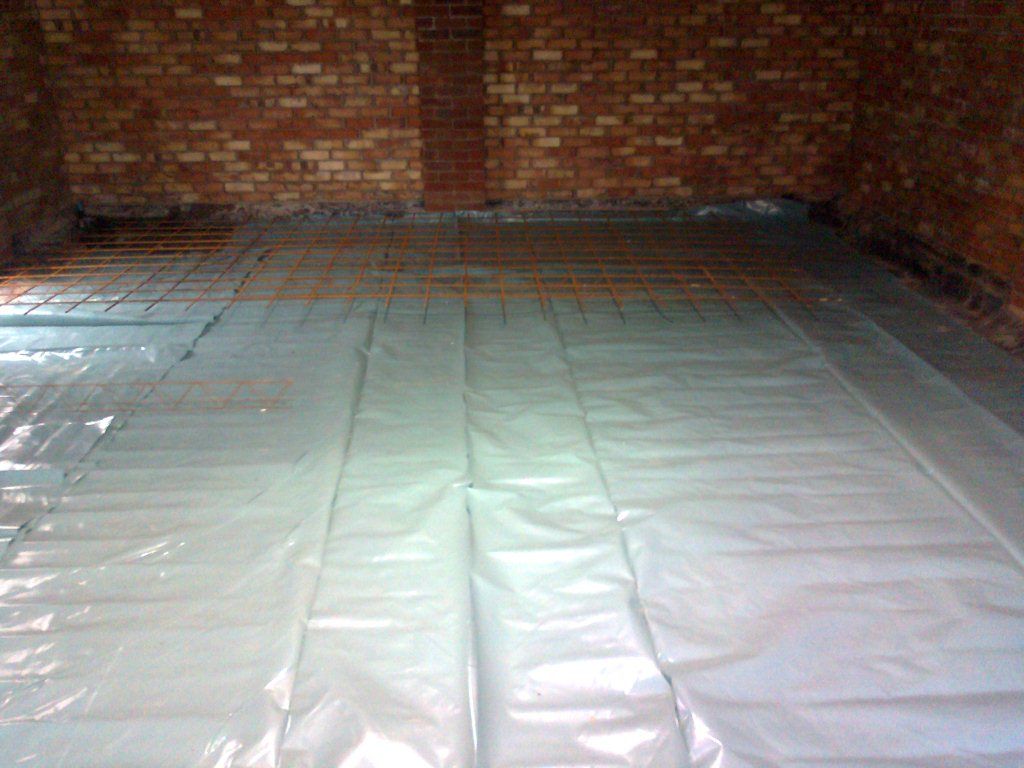

Another quick update:
The following pics show 100mm of Celotex insulation being laid...
After that, I laid plastic sheeting to act as a damp membrane, and then began to lay the steel mesh that will reinforce the concrete floor...
More to come...  :y

Where you are insulation the floor are you going to do the same with the walls with stud work and plasterboard?

Yes mate, I'll be putting in 4" x 2" studwork between the internal brick piers.  Then 3" of Celotex between the studs.  Then I'll be lining the walls and ceiling with sheets of MDF.
The reason for choosing MDF is it provides and stronger fixing (for shelves, etc) than plasterboard, but is cheaper and gives a better finish than ply.  The walls and ceiling will then be painted in a nice, light-reflecting white.
I'll also be fitting Celotex between the roof trusses and on the gables, so it'll be fully insulated.  :y
