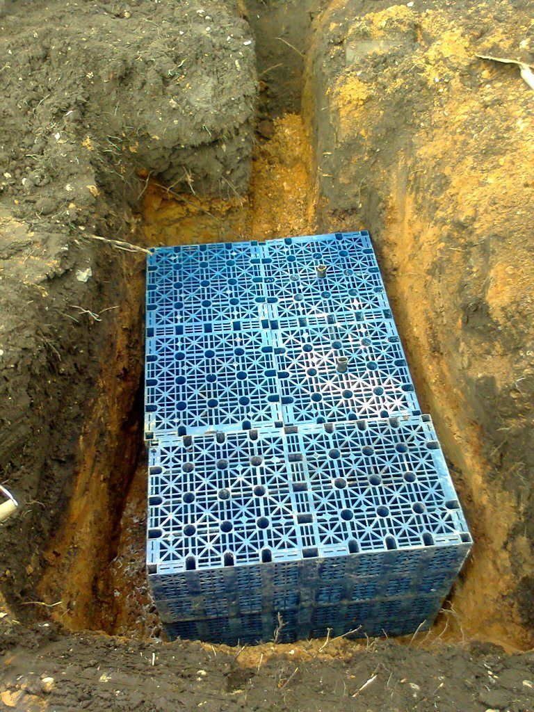

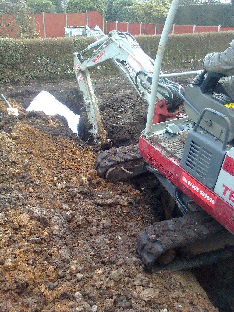

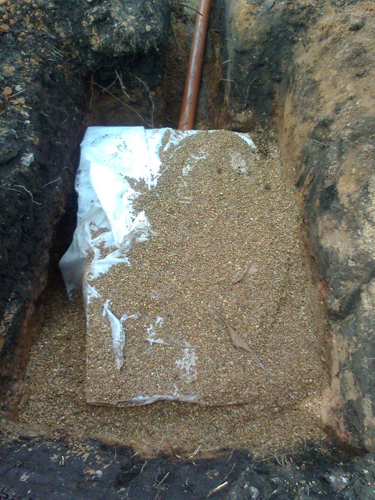

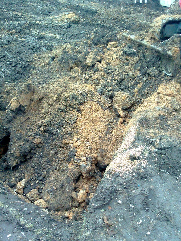

Ok, the next thing I really wanted to get done, was to get the soakaway installed, and all of the surface water drainage connections done, as well as run the service ducts back up to the house.  Here is the soakaway going in...

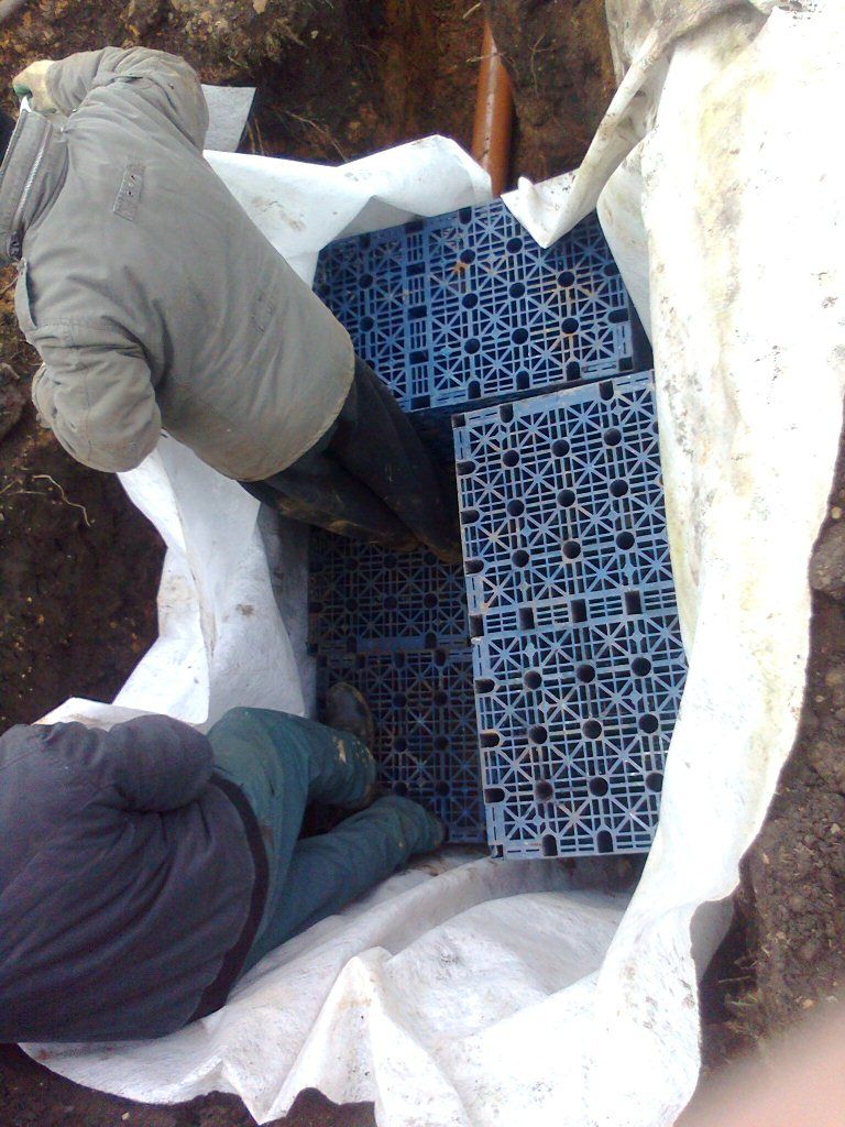

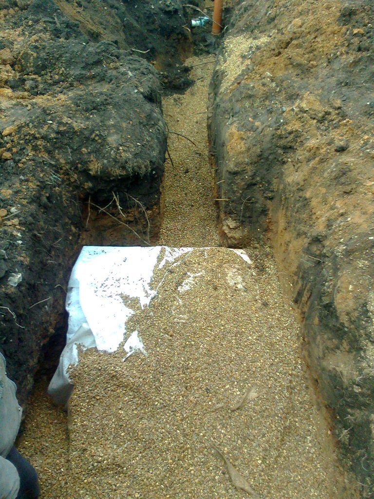

And being back-filled...

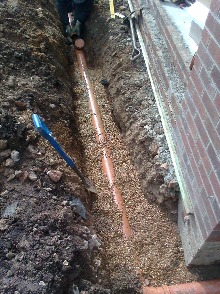

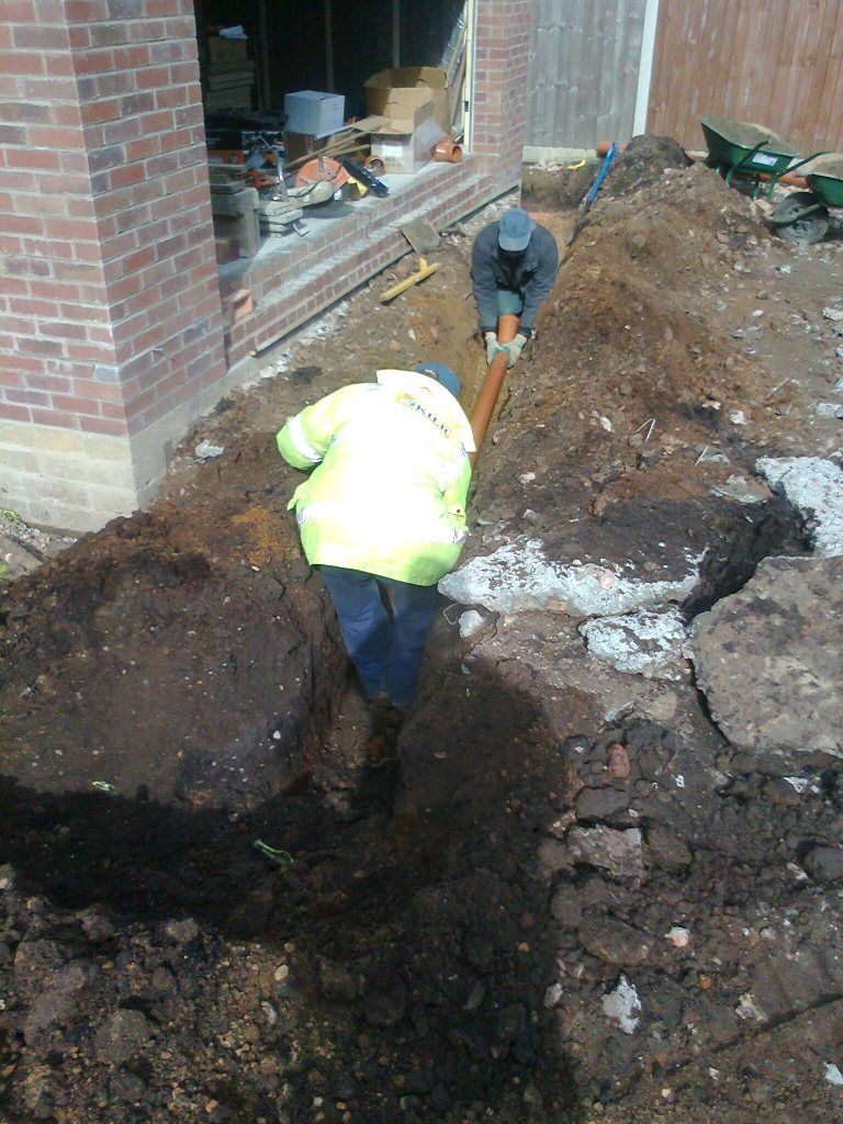

And here is the drainage pipework going in...
Note the Y fitting halfway along the pipe that runs along the front of the garage.  This will eventually be connected to a run-off drain in the middle of the driveway, to aid with taking water away when I'm washing the cars.
More to come...  :y
you did well to get a spot 5m from any buildings for the soakway
twiglet
Quote from: Marks DTM Calib on 04 April 2013, 13:05:05
Not a big problem to be honest, my garden is pretty big.  It's about 15 metres wide, so even with the garage taking up about half the width it was easy to site it on the other side of the garden and maintain the 5 metre restriction.  Building control were very happy.   :y

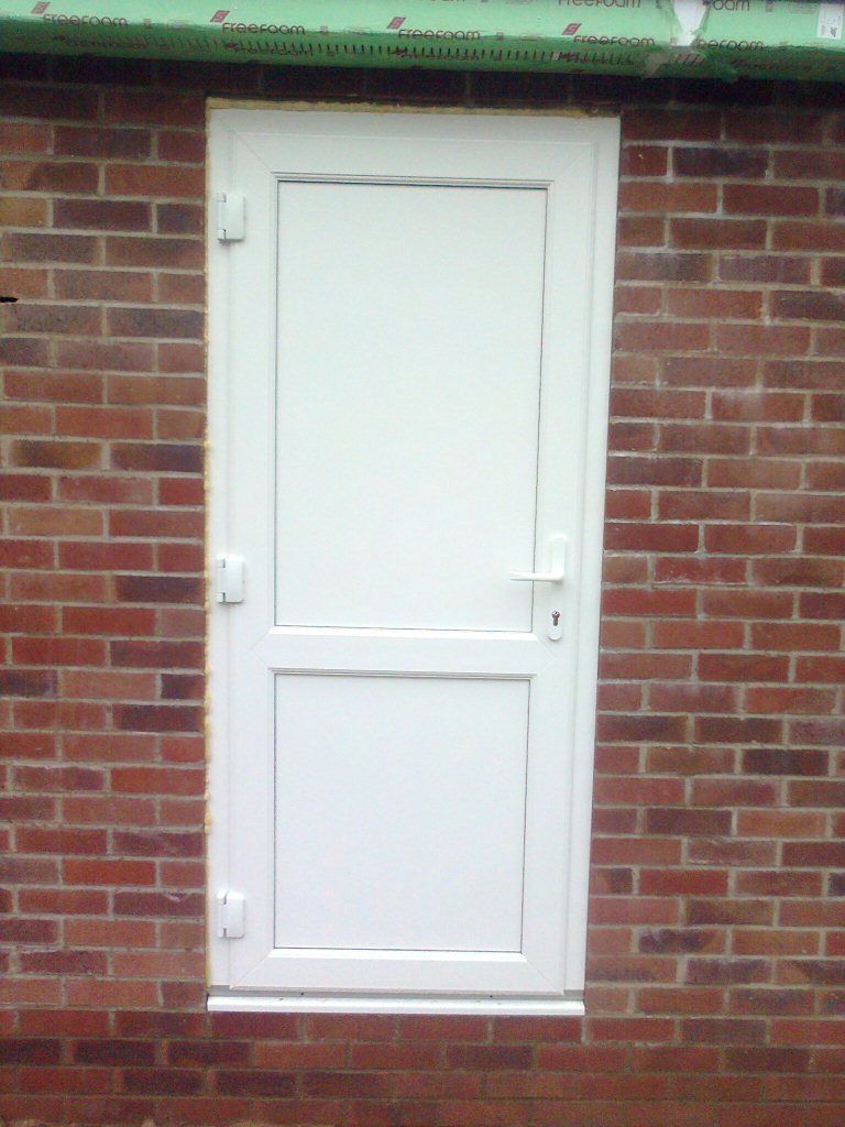

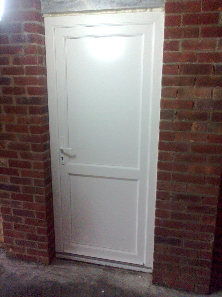

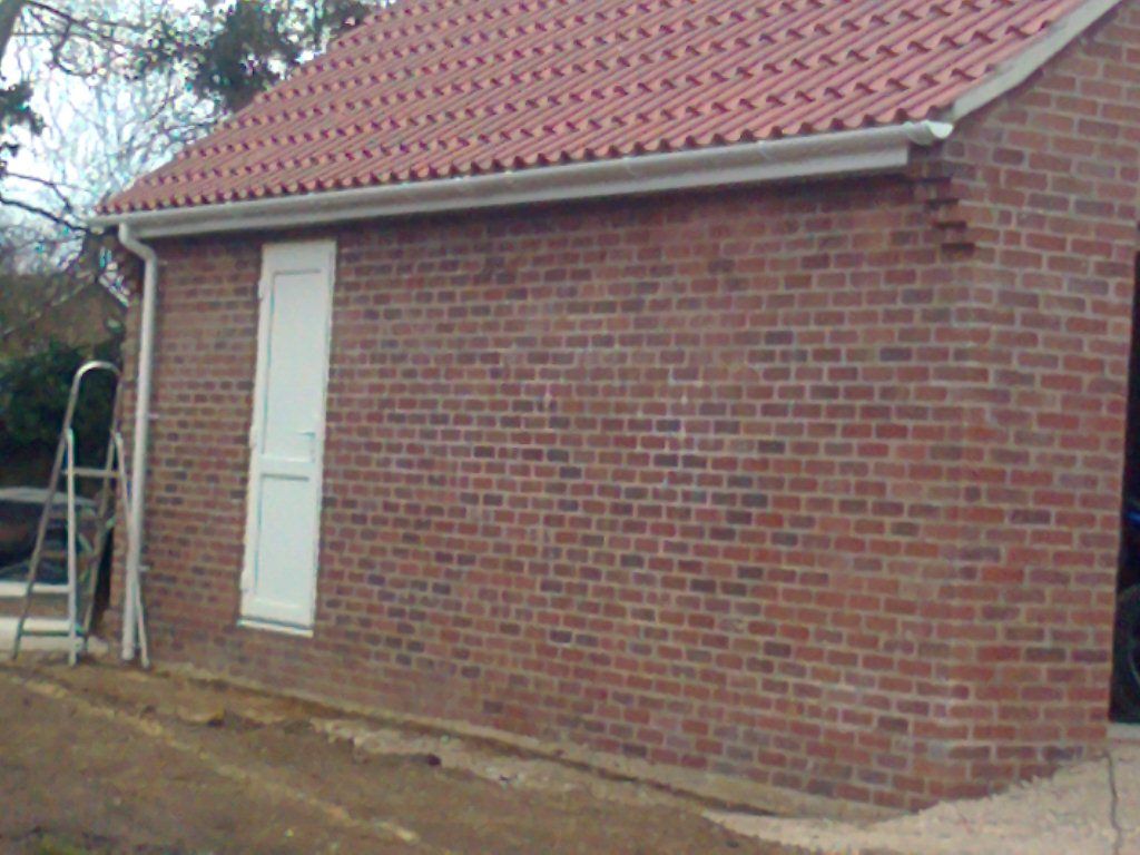

Also fitted the UPVC personnel door to the side.  Just needs a bit of trim to finish it off now...

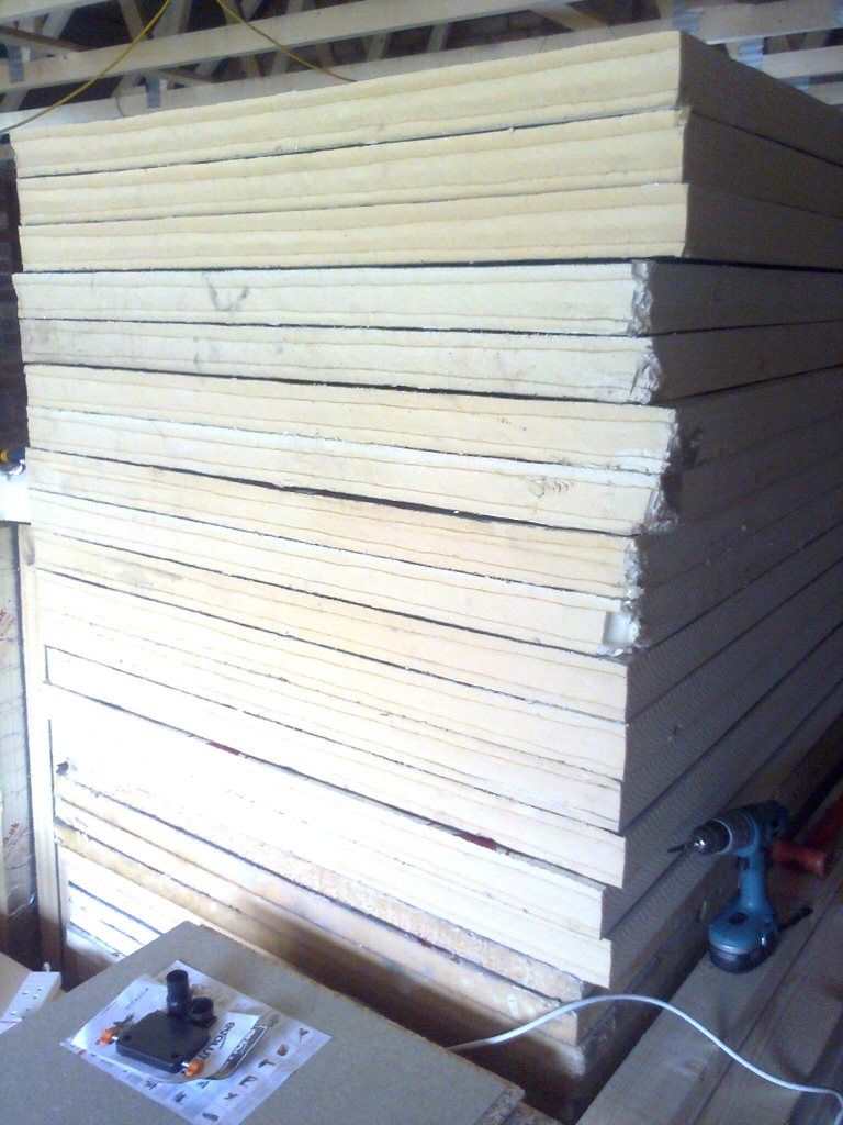

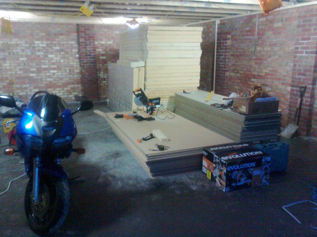

Here's a nice delivery...
3" Celotex for the walls, 2" Celotex for the roof space, 22mm T&G flooring for the loft, 12mm MDF for the walls and 6mm MDF for the ceiling!  ;D
twiglet
twiglet

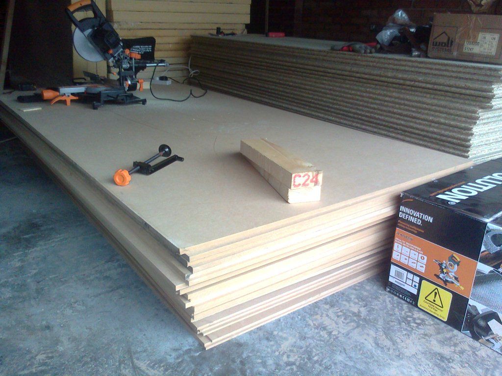

Bought myself one of these from Machine Mart for £150...
It does compound mitres, has a laser guide, and will cut wood, plastic and metal with the same disc.  I've used it quite a bit already and I'm very impressed.  :y

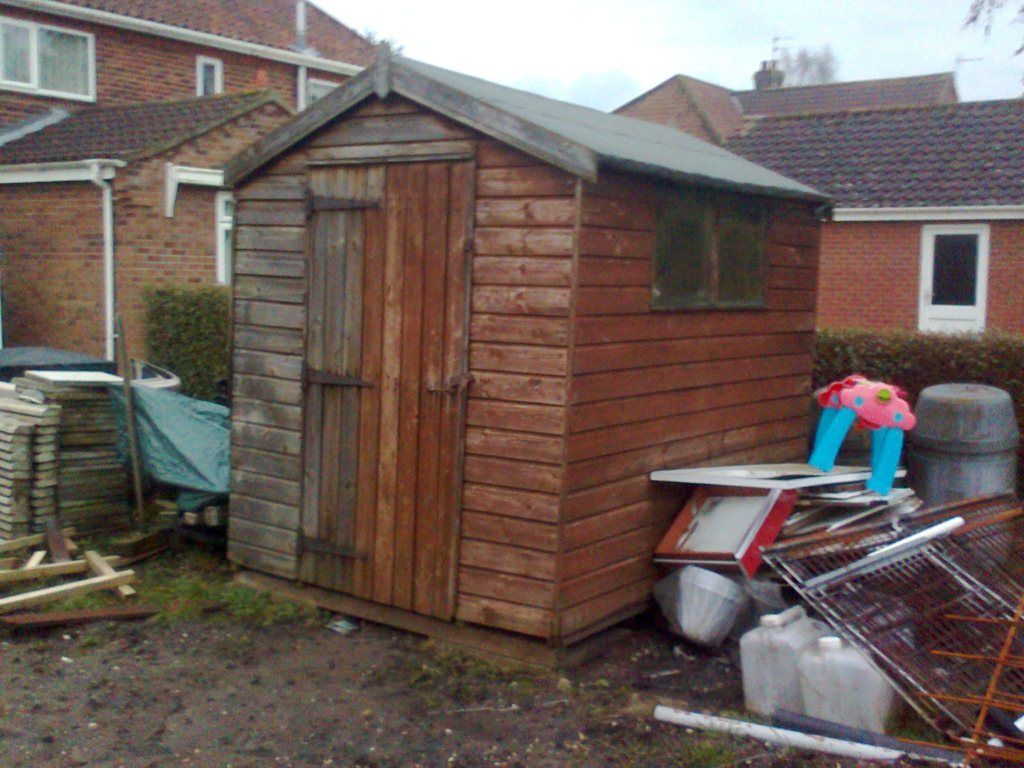

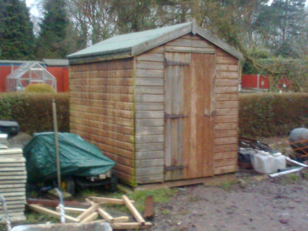

This is what the garage is replacing...
It was originally sited at the bottom of the garden.  I relocated it here and have used it as a site office.  It has now served it's usefull purpose, so I was going to break it down for firewood.  However someone offered me £50 for it, so I dismanted it and they collected it.  Bonus!!  ;D

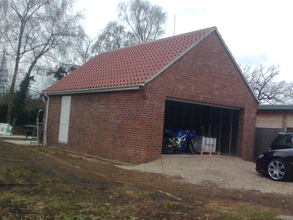

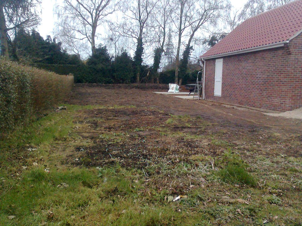

A small update...
I've managed to get all the guttering and downpipes installed...
And I've had a major clear up of the surplus materials and general rubbish.  Looking much more like a garden now...
The caption for the following picture is...
Omega says "Oi!  How did that bloody bike manage to get in there before me???"   ;D ;D
