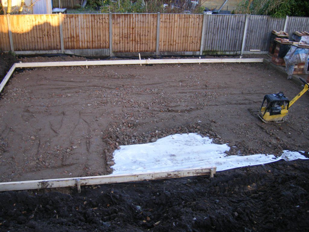

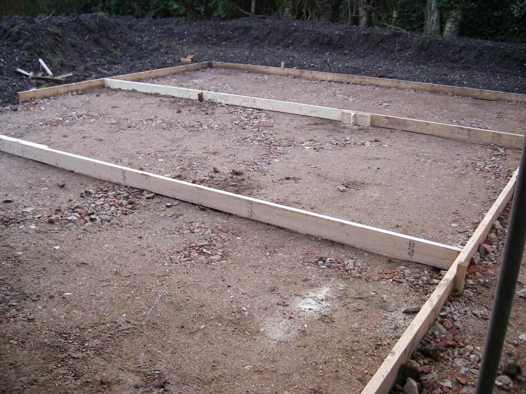

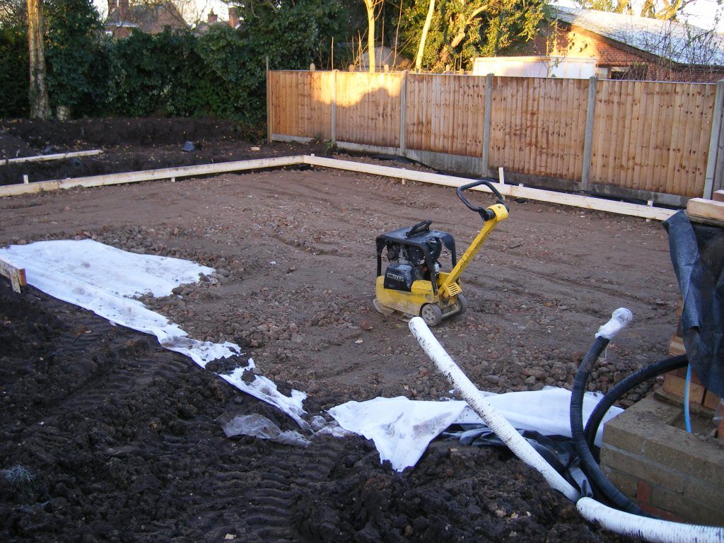

At this point, I'll briefly revisit the 'additional area' directly behind the garage.  I felt this would become dead space as far as usable garden is concerned.  I have cleared an area 9.5 m x 7m, and this will eventually provide a continuation for the path down the side of the garage, a carport area to park 1 car undercover, and space for a 6m x 5m hand made shed.  The intention for the shed is to provide good racked storage and a work area, thus keeping all house/garden/diy/etc. out of the garage.  ;D
First a base of 6" of YET MORE hardcore was laid and wackered over Tarram.  Then I used 6" x 2" timber for shuttering, dividing the space into 3 bays to make concreting easier.  It will then have 6" of concrete with 10mm steel mesh, so it shouldn't go anywhere!  ;D See what I mean about over engineering everything!  ::)

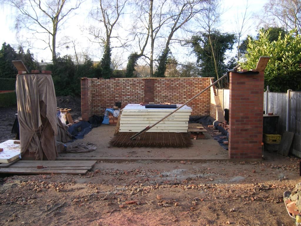

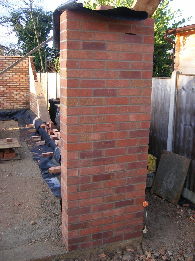

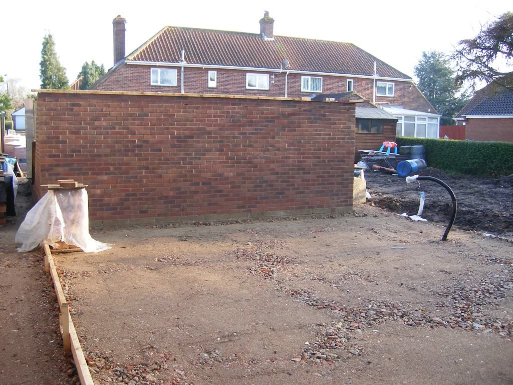

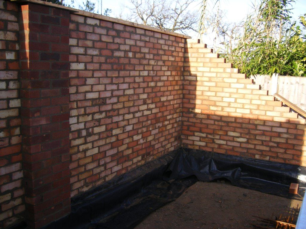

I'm sure you're all fed up of looking at pictures of groundworks by now, so the next bit should be a bit more interesting.  With 2 weeks to go before Christmas 2012, and a decent break in the weather, the bricklayers were finally able to get some bricks laid.  Unfortunately, they went at such as pace that I wasn't able to capture as many pictures as I would have liked.  Nevertheless, there are a few below...
You will note in the last picture that the inside face of the brickwork has a brushed mortar finish, rather than being pointed up.  This was a conscious decision by me to reduce time and costs.  The garage will be internally insulated and timber lined, so none of this will be seen.  For the same reason I decided to use the damaged/chipped bricks on the internal piers.
You will also note that sections of horizontal mortar joints have been left out.  Again, I decided to do this so that I could use Putlock scaffold.  This is something to bare in mind, because this is roughly half the price of a fully independent scaffold.  ;)

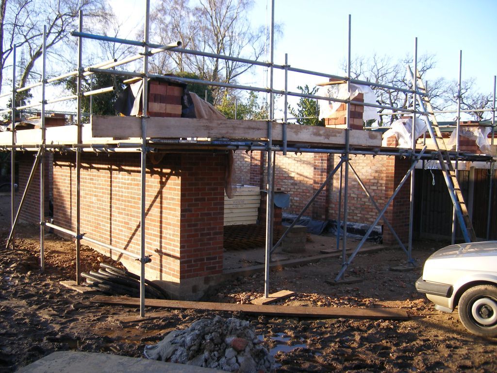

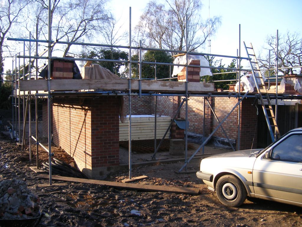

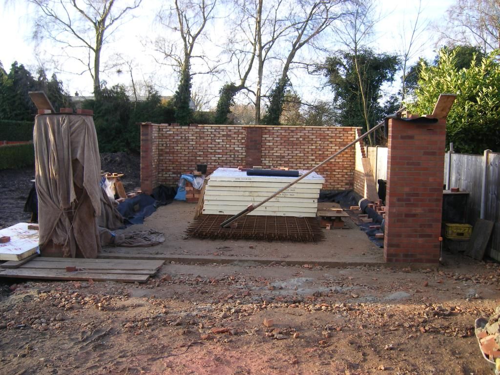

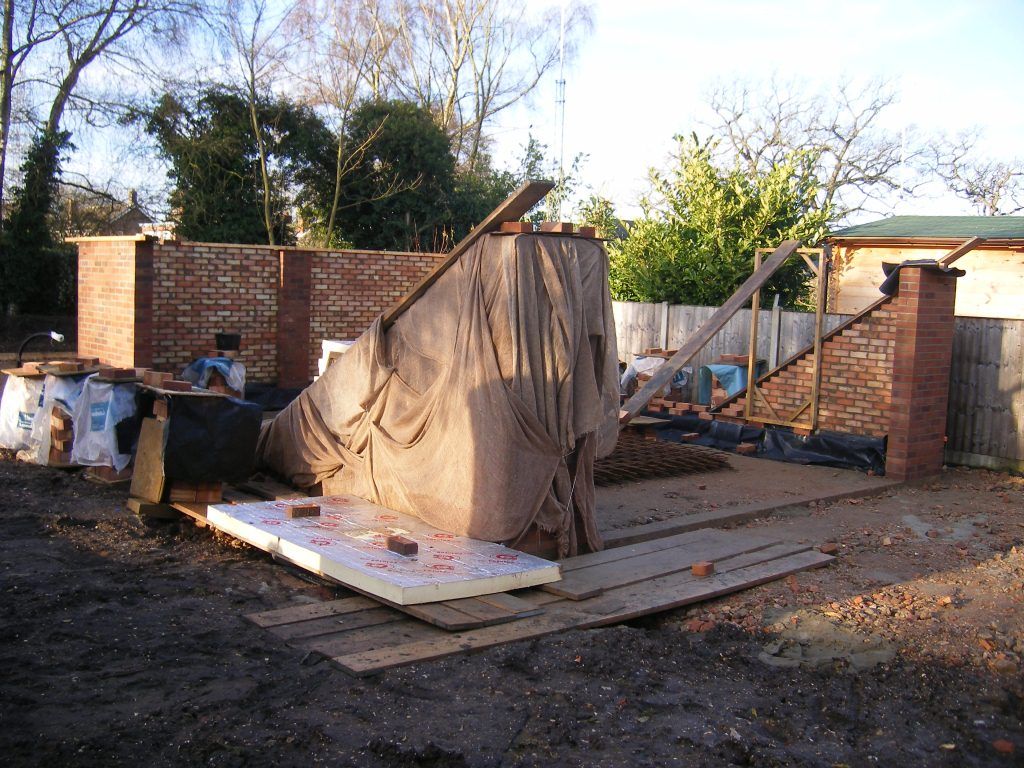

Once the brickies had got the structure up the required height, I had the scaffold errected.  The brickies then continued to bring the brickwork up to wallplate height.  This included installing the opening lintels, and completing the soldier course and corbel details...
At this point the bricklayers pulled off site, and will return to complete the gable sections once the roof trusses have been installed.
