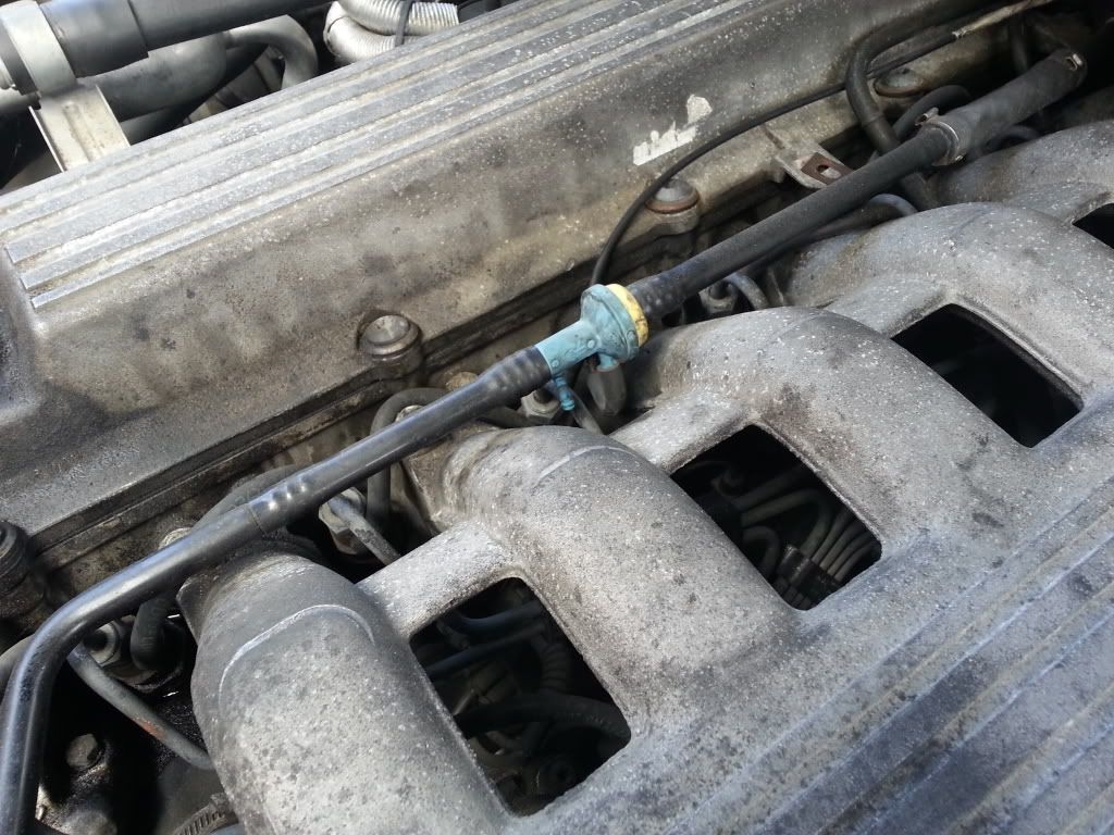

Should there be a vacume pipe or something connected next to the small pipe that is connected?

Yep, a vacuum pipe goes down the centre of the block and disappears into the bulkhead via the Pollen filter/drain housing on the nearside. I suspect it is a climate control connection, but someone will be along shortly to qualify that. :y
Yes indeed ... a small bore rubber tube that should connect to the boost sensor! ;D
Try searching under/around the forward inlet manifold support bracket for it.

Oh right. I have a pipe connected to the boost sensor which is located next to the power steering reservoir. That pipe is connected to the underside of the inlet manifold. I thought this main pipe that connects to the brake servo is connected to a vacume motor on the other end. I am new to diesels and have no idea.
Just to make things worse I just went to the shop and got just round the corner from my house on the way back and the car just cut out. Wont start now. I dont know if it has run out of fuel but the light has only just come on and the gauge is not right on the bottom. If it is out of fuel do I need to bleed it before it will start?
Will see if I can find a photie ... :P
Mine goes through the bulkhead Seth, as above. :y

The pipe that is connected goes to the back of the engine then through the bulk head on the passenger side. Is there supposed to be something else connected to the blue t aswell as the pipe going through the bulkhead?

« Reply #21 on: 06 May 2013, 00:18:36 »
^^^  Correct  ^^^
BUT ... there's also a second pipe that connects the sensor to that 'open' connection in da photie! ;)
Aye, we knows that ... but da 'missing' pipe doesn't ... Ya needs te read ma reply, man ... ::)

I did look for a loose pipe but couldnt see one. If its missing where is it supposed to connect to? If I knew that then I could try tracing it from the other end. Will take a pic tomorrow of some other parts and post them to see if I am looking in the right place for the boost sensor.
^^^  Correct  ^^^
Strange, as my second pipe, as well as the other already connected, goes through the bulkhead????? :o :o :o

Do you have climate control on yours as I dont have it on mine. Will get and take some pics in a min and get them on here

Found the pipe. Reconnected it and it doesnt make any difference. I will be servicing it next weekend. Hopefully that might make it better.

The eml light flashing is a bit worrying this could be the injector pump failing if it is the next thing that will start happening is it will stall when your slowing down at a junction or traffic lights.
As for the vac pipe the end that goes to the bulkhead is a open to atmoshpere. It should have a small filter on the end of it if not fit one.I used a small inline fuel filter.
