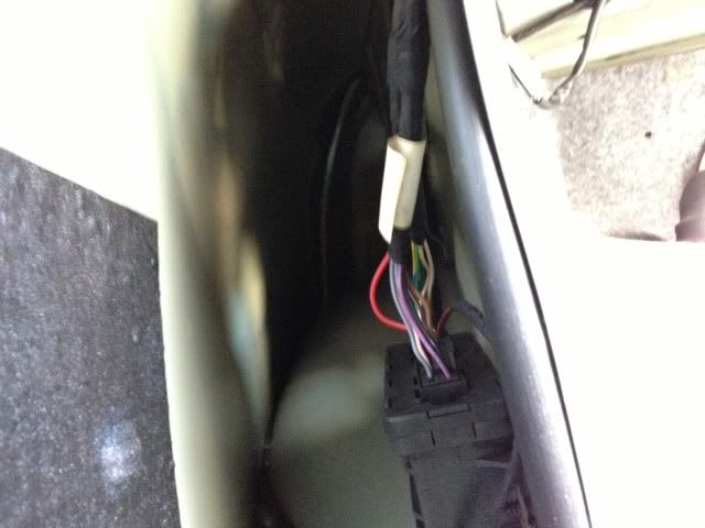

Control box is up in the space behind the spare wheel, between the "skin" for want of a better description, speaker lead is quite long and the plug can be reached without taking the box out, but its only held in with 2 screws anyway ... :)
Aye I saw the box used the phone to take pic's of it to see it uploaded one of it on previous page #76 if that's the correct box..
Did take a few pictures of it here's some more.

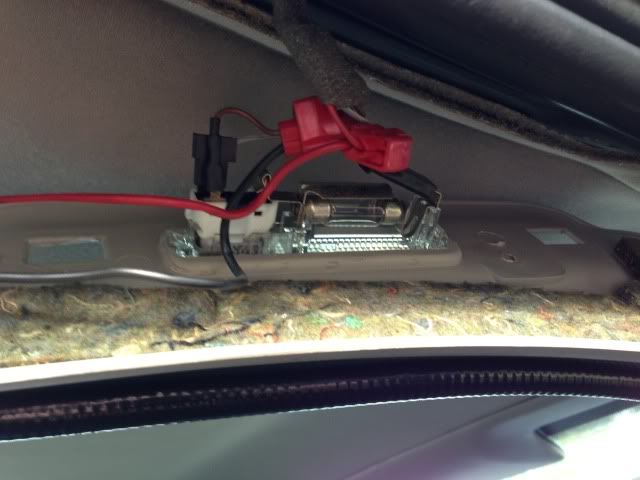

Did take the roof padding off around the sunroof area didn't see any wires or anything really apart from some black foam padding squares probably sound proofing :-\. Picture below is of the roof lining down near sunroof can't see much in picture but there was no wires visible anywhere .

you can see the speaker wire plug there quite easily .. brown wires ... my next act would be to unplug and use a 9v battery across the speaker side and see if you can hear "clicks" as you make/break the connection ... very crude way of testing a speaker ......   :(
The 2 light and dark brows wires in the 2nd / 3rd picture are the parking sensor speaker wires then.
Will try and trace the wires to the speaker hopefully tomorrow.

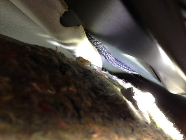

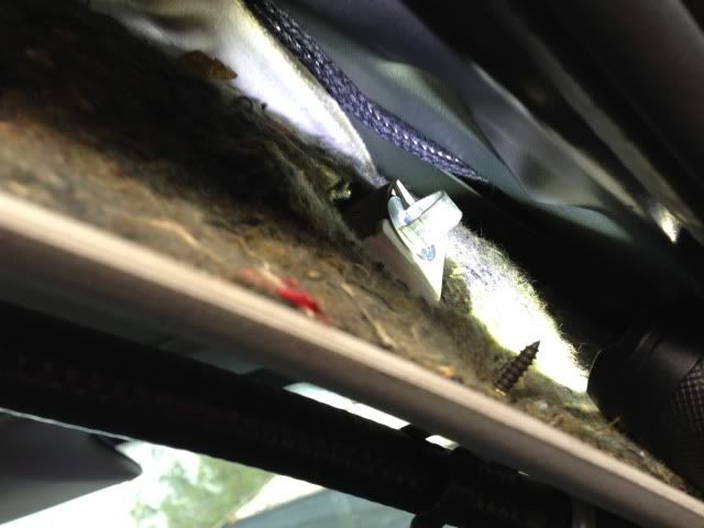

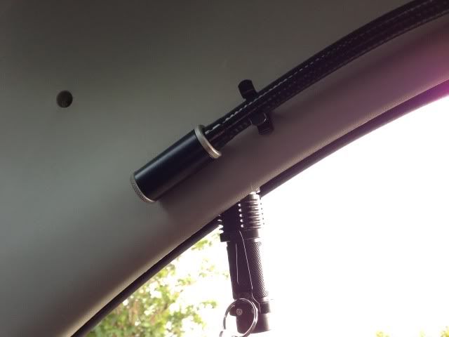

Well that's it for now giving up again  :P  ::)
Been pulling things apart this evening trying to find this thing to no avail..
Unless I can connect a speaker in the boot i'll leave this job till a later date.
Some pics of today's waste of time spent.
I Appreciate all the help nevertheless.
