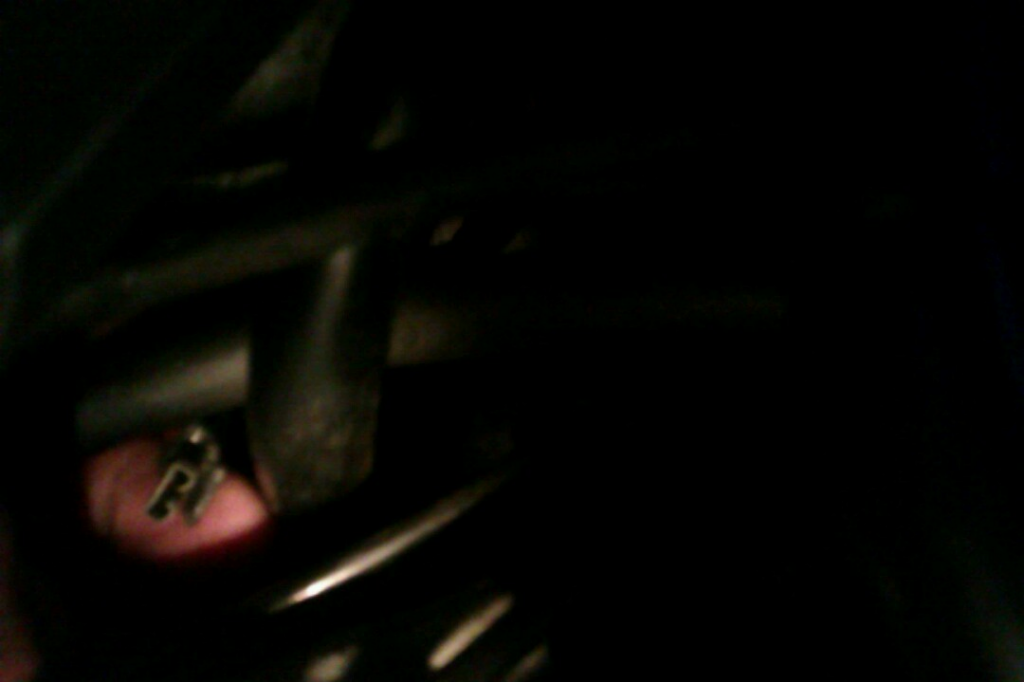

I knew I should have taped the screw on refitting as it is now sitting where the oil cooler plate is >:( Might be able to retrieve if I had a long magnetic telescope thingy but I will try tomorrow. When trying to retrieve the screw I noticed an unplugged small grey electrical connector at the back of the engine - anyone know what this is? I have a photo and will try to post it up.

what colour is the wire? The temp (gauge) sensor uses a normal spade connector and that has a blue wire

It was black.

Thanks for the suggestion - was wondering if it had anything to do with the old crank sensor?

In the maintenance guide to change the coolant temp. sensor the 3rd pic down which has the cts arrowed, the thing to the left of it shows a connector - mine looks like that

I still think temp gauge sensor then  ;)

Thankyou - you the man :y

Spade connector goes on the brass nipple next to the arrowed connector in the pic as Andy says. :y
