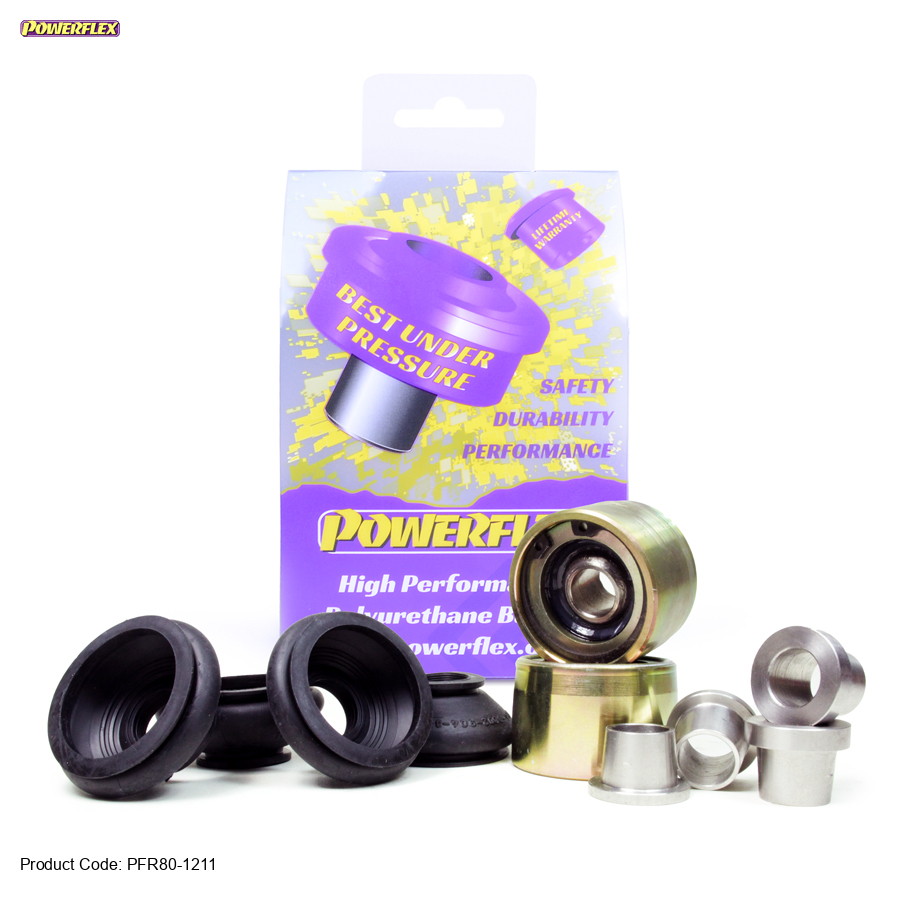

Here's something I found on the PowerFlex site. Could this be used as a substitute for the damned Rear/Vertical Bushing? It's a Heim Joint end of sorts. They make it for the Cadillac BLS. Might be the answer for us.
http://www.powerflex.co.uk/road-series/product-details/Rear+Upper+Arm+Outer+Bush/1974.html

Yeah I've been in contact with Powerflex a year or so ago. Main problem seems to be the omega has a 14mm bolt hole. Almost all of there ball joint type rearward bushes are for much more popular front wheel drive cars with a 12mm bolt hole.
With the size and weight of the omega I'm not sure I fancy fitting a smaller bolt, especially the way some members wang these cars about.

The only bush I can see that (Meyle) they make, while cross referencing sizes, that comes close is Corsa c that is also 46mm high, but the outer diameter is way too big at 60mm with a 12mm bolt hole.
Unfortunately the omega rearward bush does not cross reference with any other vehicle, the hope being that a more popular car might have a poly bush in production, like the BMW fronts.
Also, the amount of vertical travel on some of the more basic designs, like golf iirc, means there's also a chance of the ball popping out of the bush, so a metal case type is much preferred I guess. If only a suitable size could be found. :(
I haven't checked their web site for a few months now, so they may have released some new products recently that might work.

Looking at the link, that Cadillac bush is only 47mm in diameter, so is 2mm too small :'(
« Last Edit: 30 May 2014, 09:35:19 by Taxi Al »

Could have a metal band pressed in around it. But bolt size and depth of the metal body on full tilt are more of an issue.
I don't suppose there's any dimensions available? As I rekon by the time that wasted spacer is drilled out to 14mm the thin end will be drilled away to nout, personally. As that looks less than 1mm at the thin end, compared to 3 or 4mm at the widest.

Chris, if you click the link and the download the fitting instructions, there's a clear picture of it assembled... drilling it out is the least of the concerns :-\

What about a rose-joint and put it into a poly-sleeve..

It needs to prevent vertical movement of the arm over the bush, whilst allowing the arm clearance to pivot around the axis of the front bush, no mean feat :-\

If it clears the body, and the body doesn't clout the subframe as the wish bone tilts, then yes, no big deal at all.
The spacers are that shape to for clearance IMO.
Don't get me wrong, I hope it works, but..... :-\
