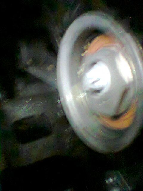

Whilst you fine fellows have been sitting indoors snuggling up with the wife in front of the fire, young Bear has been working on his Omega in the freezing cold! Haha I say freezing but it wasn't bad at all. I DIGRESS.
Firstly I trust it's usual for the car to sound like a bag of shite with the bagpipes out and ancillaries removed?
Ok so to locate this squeaking I stripped down the front stuff. as said i'd already run the car without the aux belt and the squeaking remained.
every time I removed a component I started the car until it went away..... as soon as I removed the aux belt tensioner it went away.  ::) had problems with this previously. god knows how I'm going to get around that.

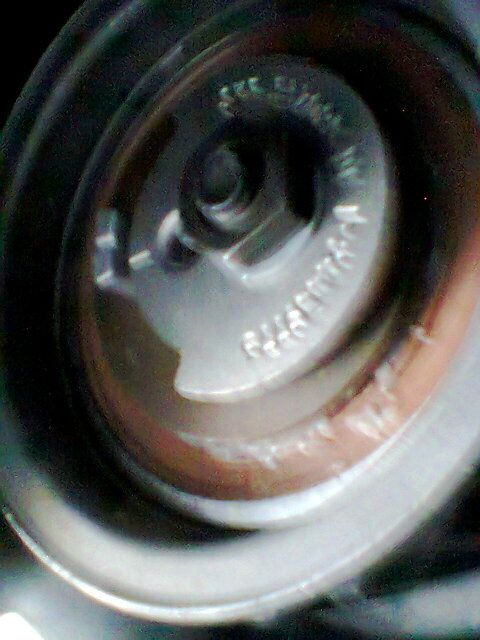

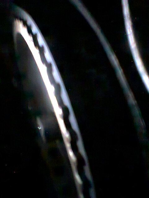

anyways, more important than that was when I gave the belt and pulleys the once over.... belt looks clean and dry although its quite far back on the cam sprockets. that normal???......

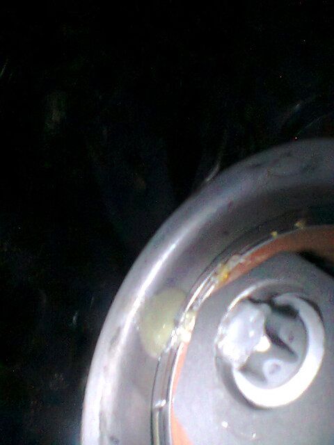

then looked at the tensioner and idlers  :o :o :o :o :o :o theyre all appear to be leaking grease.... I trust this isn't normal???  :'(
new cambelt kit??????

Yep, the bearings from new will be slightly over packed with grease, on first running they expel the excess, perfectly normal.
Nothing wrong there at all.

They do, and from the idlers.
Ok thanks Mark. ill button it back up then  :y
