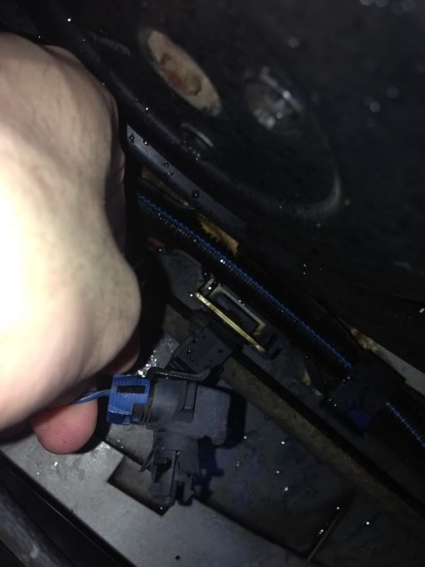

When filling up with screenwash this morning I saw this
Any idea what it is and where it goes. Couldn't see any obvious slots for it to go.

Looks like outside temp. sensor, located towards bottom of bumper in centre

I'll have a feel around the bottom of the bumper and try and slot it back in. It's a very short wire so shouldn't be to tricky.

Yes that is definitley the outside temp sensor and just push fits into a hole in front bumper area :y
