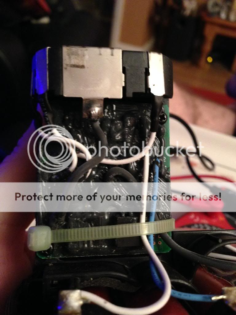

chrisgixer
Re: Repairing your cordless batteries
« Reply #43 on: 02 January 2014, 22:56:47 »
...and the board. I guess they don't want anyone getting in there, going by that black stuff painted all over it. :(
