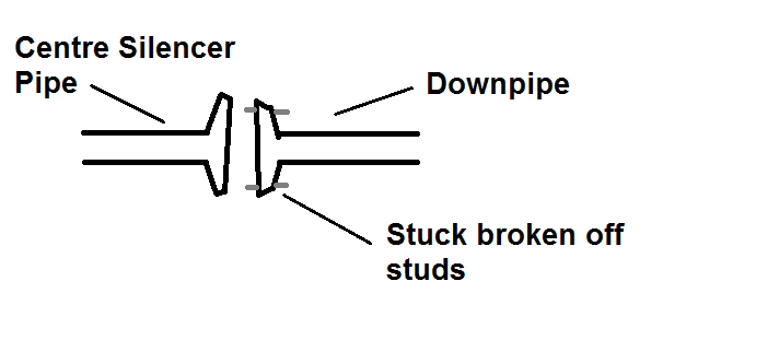

Forgive the crude drawing, TA  :)
Those stuck studs will not come out for love nor money. I tried heating them up and removing with molies. No chance :(

Re: Exhaust downpipe to centre silncer bolts... hacksaw?
« Reply #22 on: 14 February 2014, 15:30:25 »
Ah ok :y
Pop it in a vice and bang them out with a hammer :y They're only a push fit, albeit a rather rusty one :y
« Reply #23 on: 14 February 2014, 15:34:15 »
Ah ok :y
I was going to do that, Al. But the nuts connecting exhaust to manifold have also seized and won't come out so I cant get it out of the car  :'(
« Reply #24 on: 14 February 2014, 15:43:32 »
Could do it on the car, downpipes in place, just means using a smaller hammer :y
« Reply #29 on: 14 February 2014, 16:25:34 »
Remove exhaust, get a good hard dot punch. Make sure the old bolts are flush with the flange,heat till very hot, nearly white, then put dot punch on bolt and give good solid whack, should come out. It is a two man job.
