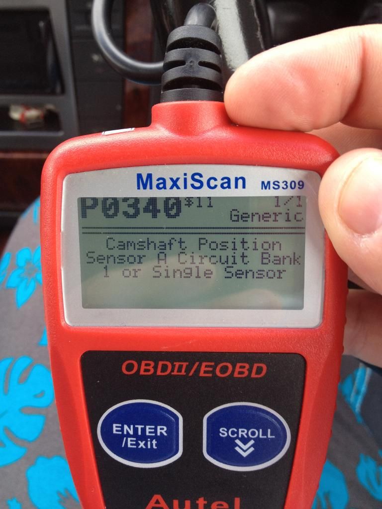

Brought this one on eBay for £12 odd. Does the job it needs to and resets the engine light to :y
http://m.ebay.co.uk/itm/111400687669?nav=SEARCH

yes that will do the job...as for gearbox fault oil/filter change may be in order as both my 2.2 did suffer with holding onto gears/rough changes until oil/filters where replaced :y

Ian, does the Maxiscan work on a 2.6 V6 facelift?
Ta.
Ron.
Ta.
Ron.
No idea Ron all I know is it works on my 2.2. One of the more knowledgable members may well know :y
(RobG please stand up ;D)
Ta.
Ron.
Yep

Top tip Ian with the ebay code reader, ill give it a shot. Thanks for that.
