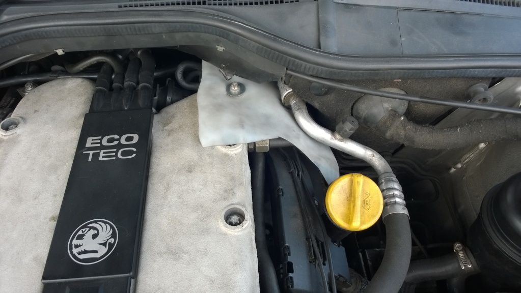

try this no need for silicone or sealent
[/img]
« Last Edit: 29 November 2014, 15:13:33 by biggriffin »

Having worked on a car with misfire issues and such a plate fitted, I'm not convinced :-\ ok said car has lpg fitted, and some of the wiring routing is less than ideal, but even in your pic you can see where the aircon plumbing is wearing a contact patch on the plate, presumably with a corresponding one on the vac pipe underneath :-\

« Reply #6 on: 29 November 2014, 15:21:58 »
aircon pipe dosnt touch the vac pipe., have had no misfire issues on any of my v6's using this method.
Hoof'land storeman.
Re: Scuttle leaks causing misfires
« Reply #7 on: 29 November 2014, 15:27:50 »
I'll wager the plate does... anywho, if it works for you, great :y

Biggriffin. I'd suggest stop drinking the local water. That ac tube is wearing through the plastic by the looks, without the rather flimsy plastic clips to hold the two appart THEY ALL wear through the vac pipe in the end ime.
