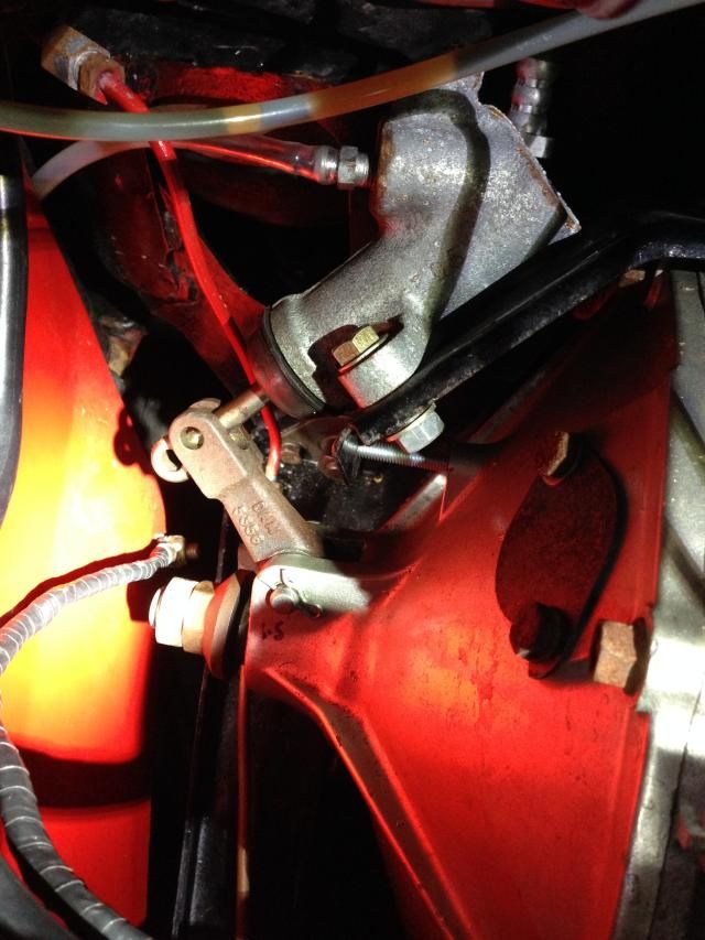

Anyone know about Mini clutches?  The pedal doesn't fully return up when released.
Tried bleeding (but not reverse bleeding yet), no air came out, no difference.

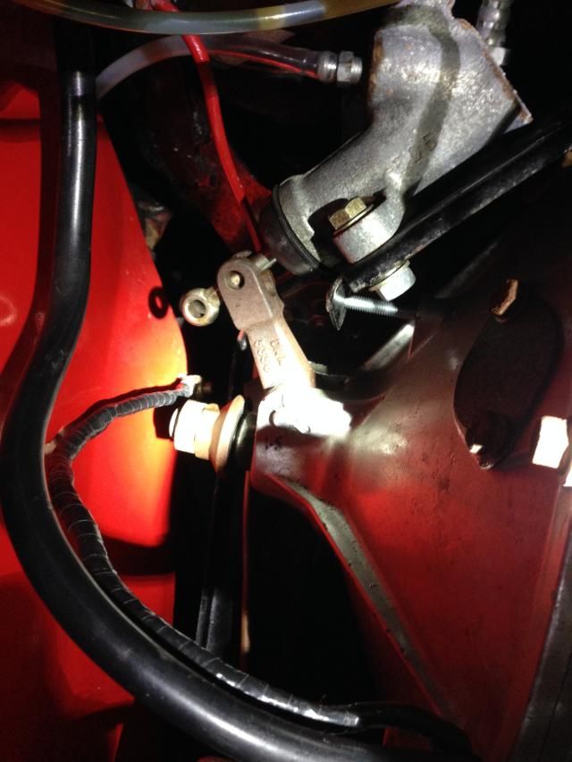

Disconnect the slave from the release arm, there is a fair amount of play in the arm:
Don't know whats normal  :-[

« Reply #10 on: 06 February 2015, 11:37:22 »
Where the operating rod goes through the aluminium cover is prone to corrosion and seizure,I'd be oiling that bit up then work the pedal to free it up
the rod into the clutch, as that's pretty free to be honest. That amount of "play" shown in picture I could do with my little finger.

« Reply #13 on: 06 February 2015, 12:55:39 »
There should be a return spring, that hooks into a little metalclip on the clevis and back along the slave cylinder. I think there might also be one on the pedal, but can't be certain.
Re: Mini clutch
« Reply #14 on: 06 February 2015, 13:05:03 »
Yeah, that picture looks like it's missing parts 15, 17 & 18 from this list, to me: http://www.rimmerbros.co.uk/Item--i-GRID000968
(The larger picture makes it much clearer where they should go)
Come to think of it the picture looks like it's missing the clevis pin that links the clutch lever to the slave cylinder?
