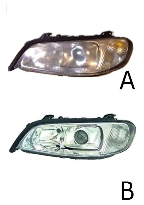

Ok. Which do you prefer A or B, please?  :)
Thanks  :)
Re: Parts compatibel ?
« Reply #11 on: 17 February 2015, 15:16:20 »
Can I abstain?  ::)
Diamond Black Geezer
  • Posts: 5723
    • & a silly coupe coming...
« Reply #12 on: 17 February 2015, 15:18:22 »
By all means..  :) One of them is Cadillac Catera, one of them is Omega. I suppose it's 'place your bets gentlemen!' time :)
« Reply #13 on: 17 February 2015, 15:23:10 »
Lower one is not the Catera one ;)
« Reply #14 on: 17 February 2015, 17:17:25 »
well, that's right. none of them is catera. at least not the one i have with the car on the picture.
the one i seen have led light strip integrated for Day Driving Lights DRL, and  a lot more clear then both of them.
i can't upload this picture but looking at it, zoomed in, both bulbs are hid.
so, if this are the standard options for omega and catera, the one i have on this picture must be from some other car, or special modification. something like that.
the full hid compatible lights and the lightstrip as drl was what caught my eye in the first place.
i don't think i like the car itself, although i usualy like the usa cars loads more then eu cars.
