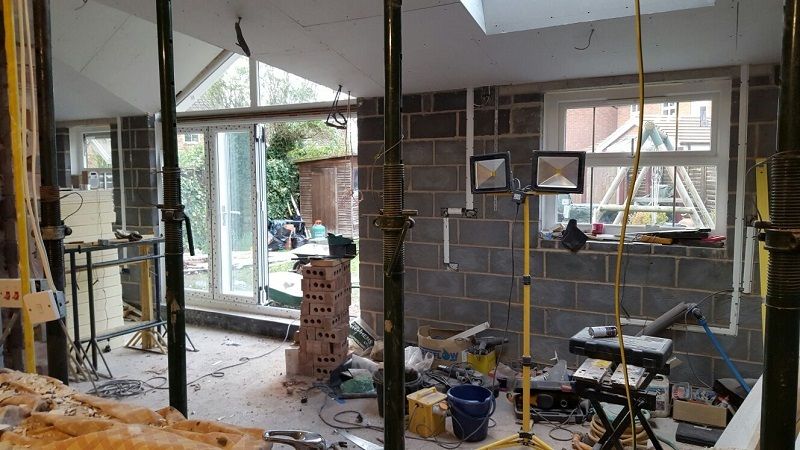

Blimey, been a while since I posted any progress!
But I have done a lot, did all the first fix wiring myself, sick of chasing so called pros so will work around that at the end.
All insulation between the rafters fitted and 50% of the insulated boarding on the rafter underside done to.
Two windows arrived and fitted and the bi-fold fitted to, awaiting the triangular window the frame for which is due today and the glass on Wednesday.

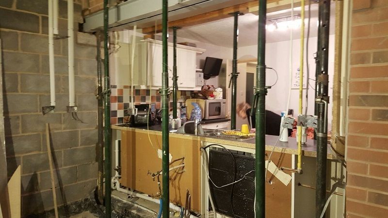

« Reply #100 on: 22 February 2016, 08:28:35 »
Further progress
Ceiling is fully boarded (62.5mm insulated plasterboard) and triangular window fitted.
So job this weekend was a big one, remove the wall and install two steels.
So after just over a day and a half, having used a series of Acrow props with Strongboy attachments on the outside (through both inner and outer leafs) and planks plus Acrows on the inside plus two additional Acrows to jack the steels into place, all was done!
Although stated as not required by the Structural engineer, I have included pad stones with the steels then packed with good old welsh slate to fill the gap.
Next stage, make good the floor joints, insulate the floor, fit the UFH pipe and get the floor screeded.

Marvelling at how clean the back of your kitchen units are following the demolition of the external wall.
I am nearing the end of my own project E. It seems that just about every task I undertook covered the contents of the house in a layer of dust ;D
  • Posts: 34112
Re: A bit of homework, Project E
« Reply #102 on: 22 February 2016, 09:54:27 »
I managed to keep most of the plasterboard in place for the duration of the work which helped a hell of a lot!
After the above photos, I created a few wooden supports for the dangling electrics so we can continue to keep using the kitchen.
I may well pin some DPM over the opening once the supports are all out to help control the mess a bit.  :y
