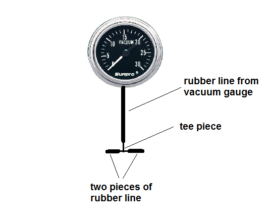

..going to tee in my new vacuum gauge off the main brake servo pipe. but the diameter of the vacuum line that came with my gauge is a bit too big to fit over those tiny diameter omega lines.
so when I order a length of rubber vacuum line that will fit over the omegas thin line, do I tell them the diameter of the omega vac lines (the really thin ones)? or what?

the vacuum gauge I want to fit in line with the vac system. the gauge came with a tee piece so ill have this...
the two rubber ends are too big to accept the thin omega lines so I figured I need to swap these two ends to thinner diameter (the same diameter that the 90 degree bends are in the omega vacuum system)

Ah... a picture ;D
Ok, ignore my suggestion :y

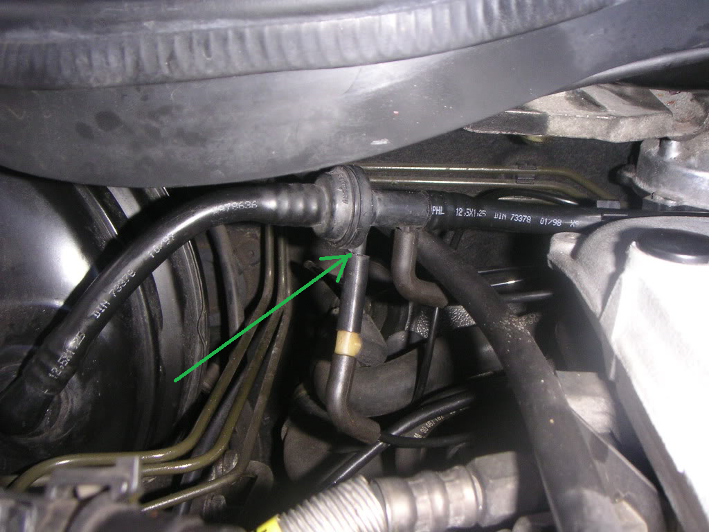

What you want to see on the gauge is manifold pressure (or vacuum). The SAI and the heater controls are fed with vacuum from the vacuum reservoir(s) which have non-return valves to hold the vacuum when the manifold vacuum disappears (eg when you have the throttle wide open).
You need to connect to one of the pipes before a non-return valve.

The HBV is controlled by a solenoid valve in the climate control system. Not what you need.
The best place to tap in would be one of the small pipes that come off the side of the non return valve in the half inch vacuum pipe to the brake servo.

Just so we're clear this is the spot, right?

That's the spot :y
