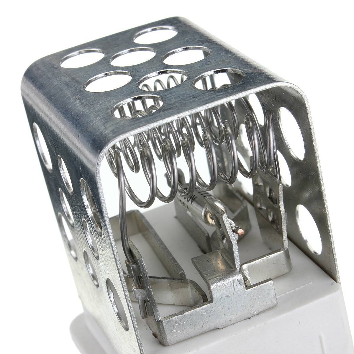

Anybody spot the difference:
Genuine
Tatt:
The real one uses a soldered copper strip instead of a clamped resistor(?) and brass tracks instead of tin(?)  :-\
I am assuming the clamped item is a thermal fuse.
The genuine has a heat resistant plastic as its base to with a moulded part which is separate, pattern is just a naff plastic used to form the whole base.

Those fan resistors do get pretty hot, so everything around it needs to be capable of withstanding a lot of heat over very extended periods. Many cheap ones (for any car) can't.
