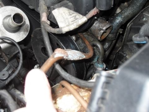

Hi, just noticed my earth cable has taken a bit of a battering, freyed against the side of the battery. Going to replace it, can someone please tell me where goes and finishes up. It seems to disappear behind the steering pump, then the plastic cowling - next to the large water inlet pipe. I will check the starter motor.
thank you for any info, did look at the posts, could not find anything, pictures would be good too.

where does it go ?

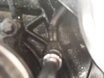

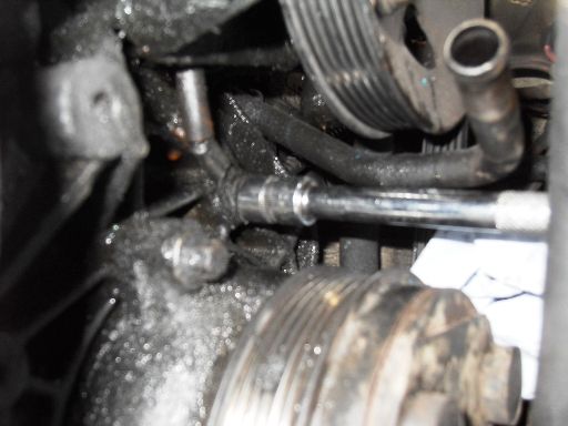

As you can see, there's the baby, in between the aircon and the steering pump, a Torx Bolt E16 Socket
Battery is out
Main Radiator Pipe is out, I am replacing it, but you don't need to take that out.
Radiator is out, I had to replace the 2 x Rad switches - don't need to take that out for the earth strap
Pictures next showing location.
« Last Edit: 29 October 2015, 13:51:24 by vauxsky »

Sorry its an E14 Torx, not 16
