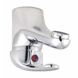

Got a leaking mixer tap in the kitchen , the water leaks onto the work surface and has been doing so for a few years  :-[ but only in certain positions . How do i fix it , does it need to be totally disassembled or can it be done by just taking the top off  :-\
Its like this :

Well managed to take it all apart without flooding the kitchen  ;D Seems it was leaking from underneath the rubber o ring"cartridge type" where the chrome plating had eroded . Cam cover sealant to the rescue  :D All water tight , only wanted a temp fix as having a new sink put in soon  :)
