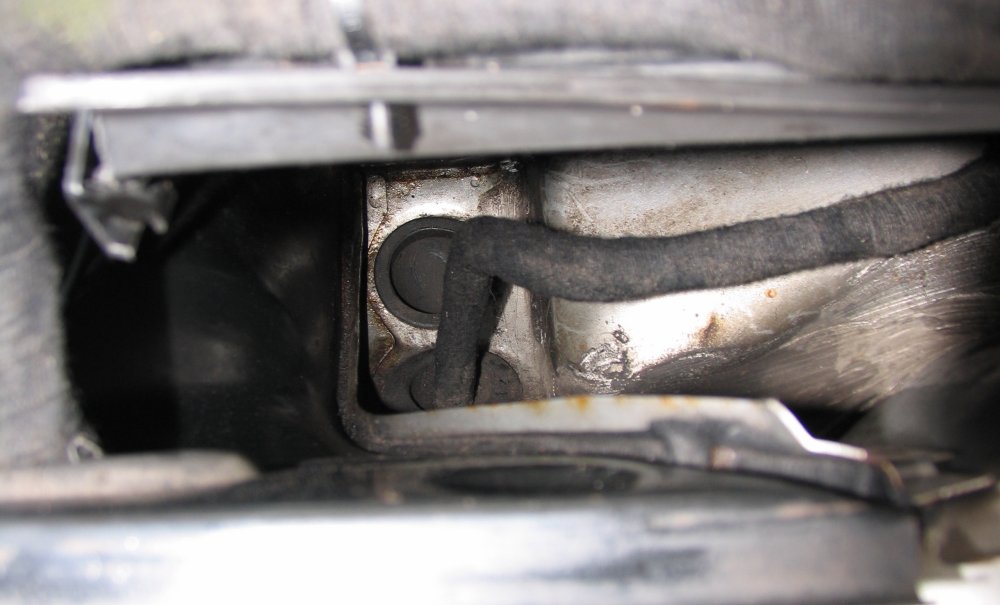

I'm in the process of tidying up the sills, and access near the rear subframe (inside edge of sill) is very tight to get in there to clean down.
The assembly bracket is held in place with 3 bolts (to chassis / body), and a central bolt for the subframe. The central bolt is obviously mated with a captive nut at the top which is not accessible when everything is in place.......  so the question is -
Is the captive nut held fully or just in a channel? I imagine once the central bolt is undone and removed, the nut may be lost, and I'd have to end up stripping out the whole rear assembly to find it again.

Thats the cover plate for the rear donuts - as far as im aware you can remove that bolt with impunity.
I personally would remove the whole plate as well, by undoing the three bolts round the outside.

No I am sure it is a captive nut and no one on here has reported loosing one and the how to guide does not state any problem with the big bolt or its nut :y

Replaced the doughnuts on my estate last year, and the captive nut wasn't an issue. What WAS an issue was having wrestled with the doughnuts in removing the old ones and reinstalling the new,  the subframe moved slightly, and then locating the centre bolt properly was a bit of a pain, probably with the tension from the springs. Maybe there's a simpler way to do it, but I ended up using a large ratchet strap and a sling round the subframe to move it to the precise position to refit the centre bolt. Just worth bearing in mind when you remove the bolt and plate.

If you support the car using an axle stand under the subframe either side, it shouldn't move.

A 12" threaded rod of suitable size might help... it would allow the subframe to be dropped both sides simultaneously without affecting geometry and could be left in place as the cover plate is removed/refitted.
Would allow much better access to that rear sill area :y
