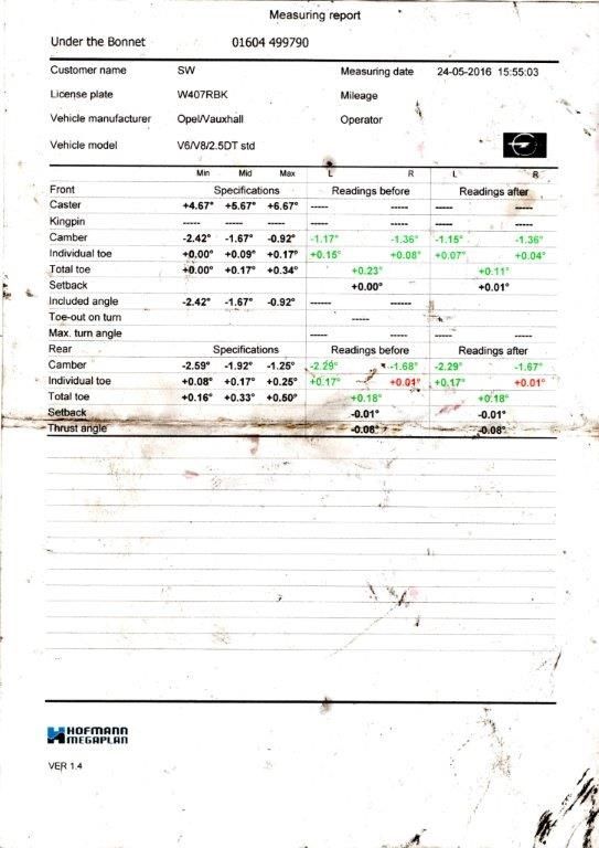

right then ladies....heres the image of my alignment (buried deep in my toolbox  ::))
ignore the before readings....the computer went wrong. the after readings are where the cars at at the moment  :y
as per Nige's post, the thrust angle is off].im presuming this is whats causing the wandering?
Everything need adjustment. Are you going to enter your car into a stock-car (nascar) type race, bet it goes round Rh better than lh. :D :)
