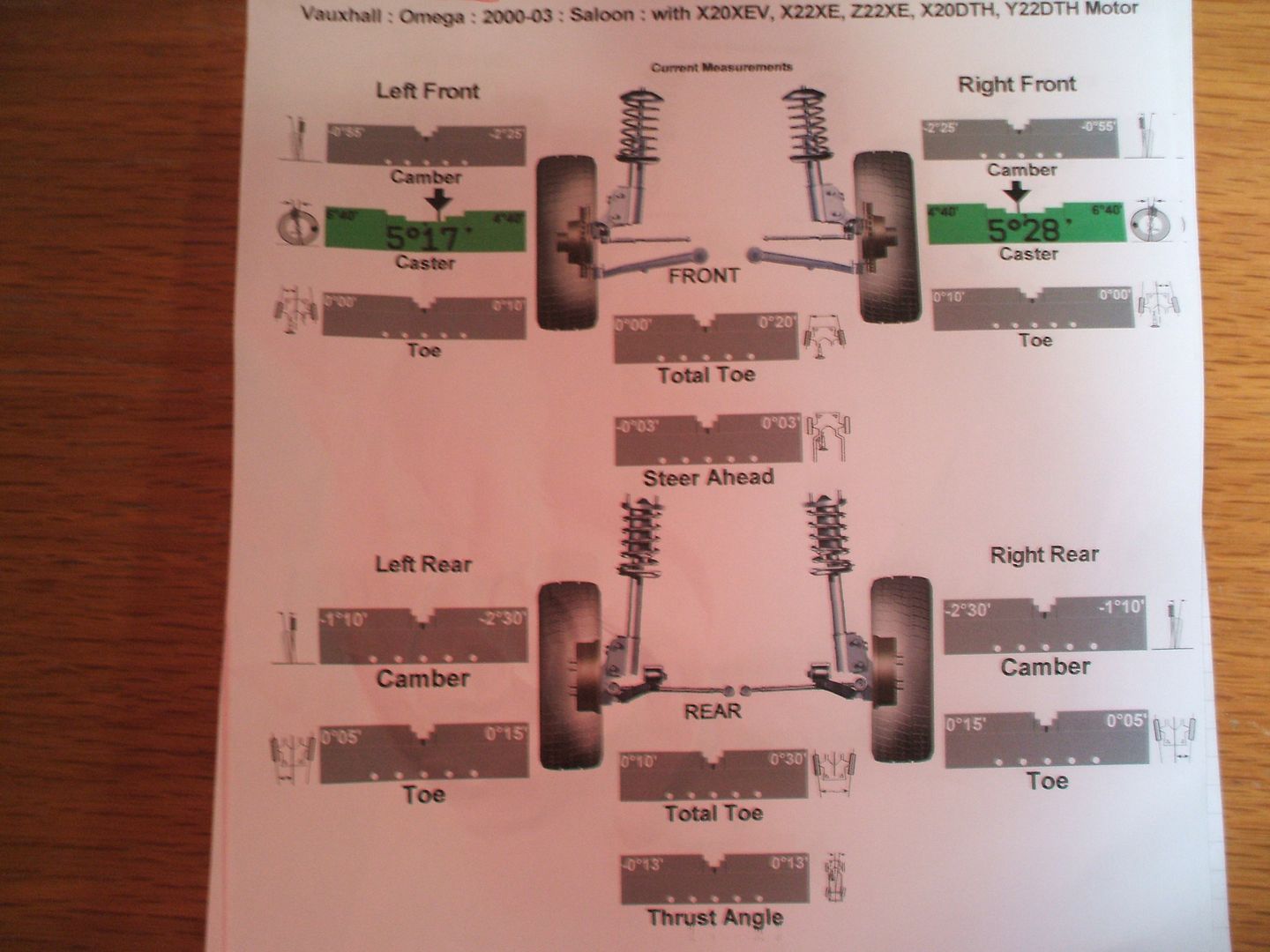

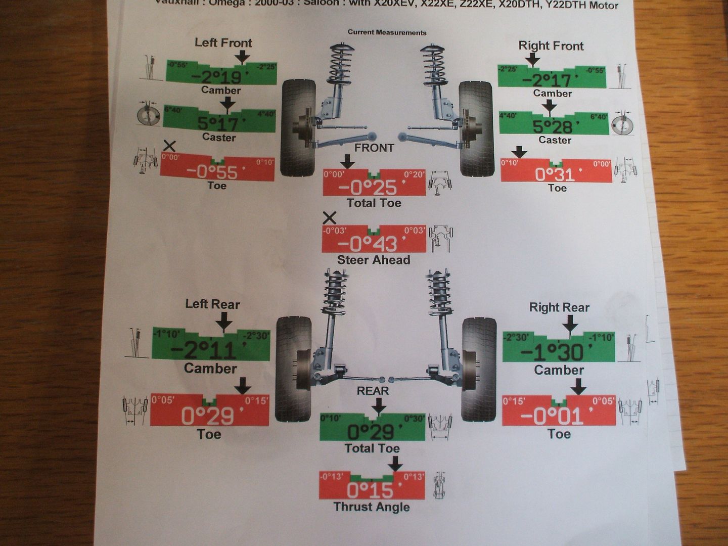

Anyway, they did the job and I have the printout, but I don't really understand what Im looking at.
There are some figures on a red background and some on a green background.
Are these before & after figures ?  :-\

Will take some pics of the printout tomorrow and post them up. :y

« Reply #5 on: 17 September 2016, 21:07:17 »
The figures don't look close to those given by you fellas.  ::)
If the figures aren't readable, I can try and do some better pics, or just type them up.

No ? Should I have been given a different / additional printout ? I did see them adjust the front & rear track rods, but I didn't see them adjust the camber.  :-\

Second page should have lots of green boxes with single bold numbers confirming a difference to the red boxes on the first page :-\

Ah, I see. I will give them a call next week and say what excuses they have.  ::)
