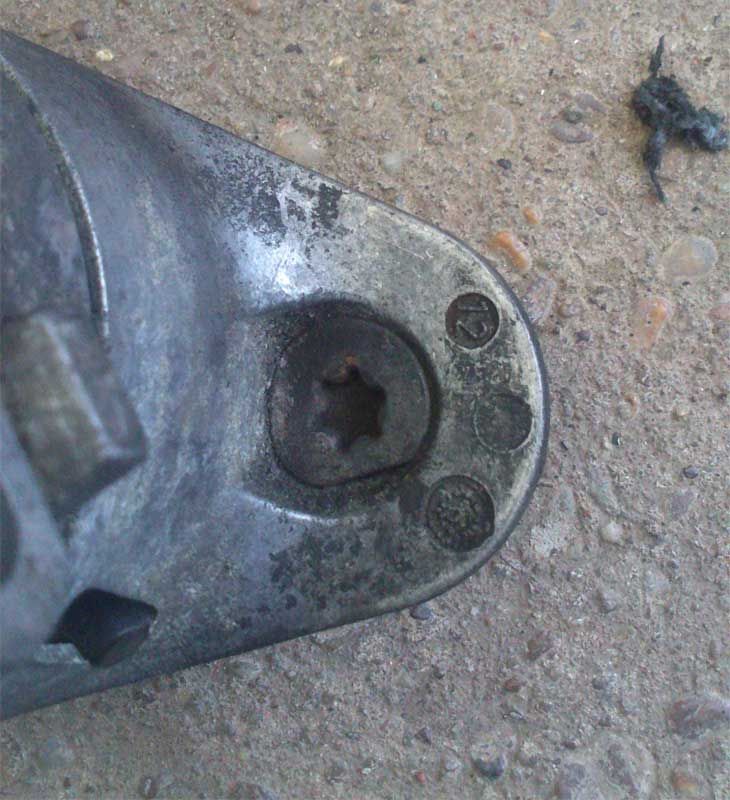

« Reply #19 on: 14 November 2016, 10:03:11 »
Found the problem... not the pulley.
As you can see, the stud / screw / bolt has rotated in the housing by some 90o, which meant the thread was off at an angle, causing excess strain on one half of the belt, causing it to fail prematurely. Cost of repair - free. (Got one off a mate's scrapper, plus a few other bits  :)) I can only assume this was by being over-tightened at some stage in its life. There was no signs of fresh, shiny alloy, so doesn't look like it was me, phew!  :D
New one done to 25Nm  :y
