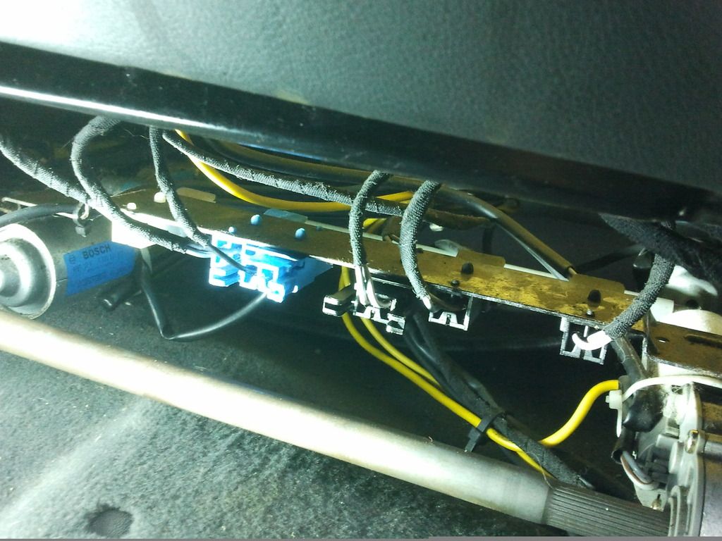

Here are the connectors. There is a white connector next to the bosch unit and there are actually 2 blue ones side by side. One of the blue ones is a single wire connector. Anybody know which one I should be testing?
  • Posts: 31122
Re: Airbag light on
« Reply #24 on: 15 March 2017, 09:48:21 »
None of those.
Sorry, but if you cannot identify the airbag wiring you probably shouldn't be touching them :-\

None of the connectors shown has anything to do with the airbags :-X

Does your code reader say the fault is PRESENT. If so, the fault needs to be fixed first.  And I suspect your fault probably lies nearer the airbag than the seat connectors.
No, indeed not.  My point being no point pissing around randomly unplugging and chemical cleaning them.
Magwheels
  • Posts: 369
    • 2.2 dti Elite saloon
Re: Airbag light on
« Reply #29 on: 16 March 2017, 21:29:37 »
I concur, SRS connectors are usually yellow, can't see any yellow ones there.
