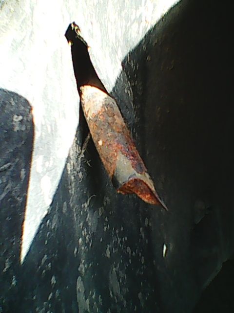

Took me a while to realise what had happened. :)

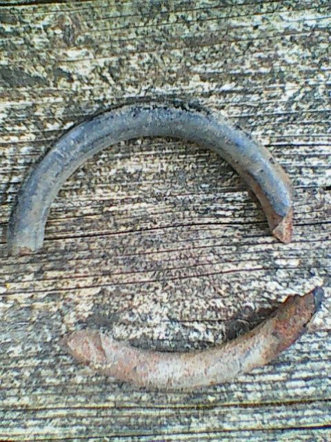

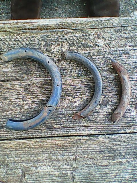

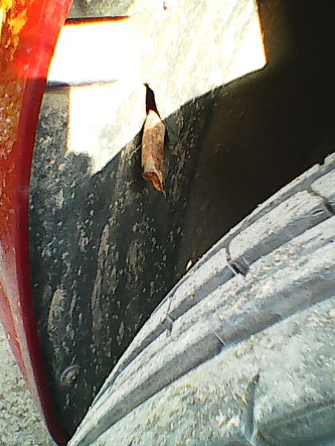

Front spring on the mighty VectraSignum
  • Posts: 33100
Re: Could have been nasty.
« Reply #2 on: 20 April 2017, 19:32:15 »
Yep.....passed the MOT a couple of weeks ago with the spring already broken.
Even though it is a much sought after Signum  ::) I'm hoping for an inexpensive and simple fix.

quite common for them to go and take the tyre out at the same time which is fun on the front being fwd.
  • Posts: 30778
« Reply #5 on: 20 April 2017, 20:43:39 »
Fords are especially prone to this as the spring seat is narrower than the body of the spring... tail snaps and the spring drops down past the seat and screws itself straight into the sidewall ::)
