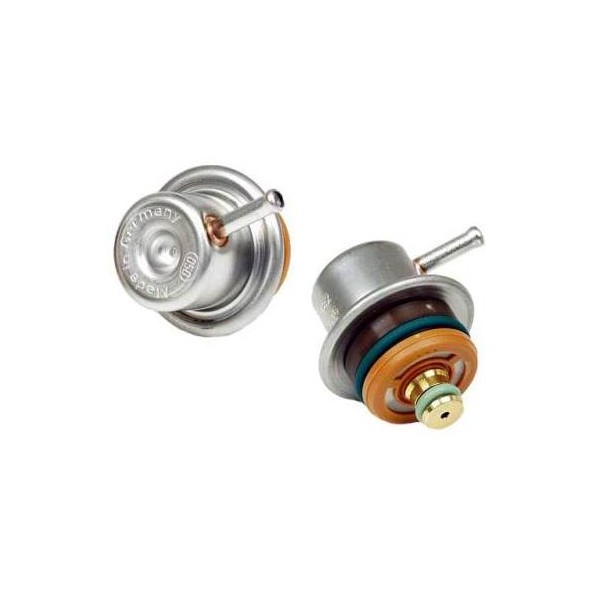

oh looked on the fuel rail diagram and inside the regulator there is a filter, (injector fuel rail), shows a flat filter on the fuel pump attached to the fuel filter. say flat funny looking thing sticks out from the pump, and then an inline one, is it just the inline one that you just change ?
  Filter, assy., fuel, electrical   gm 90466030
just checked the number on fuel injector rail and its this one thats fitted, has a filter on the bottom. http://www.blacktop-tuning.com/TheShop/hardware/103-bosch-35bar-fuel-pressure-regulator.html

Fuel Pressure Regulator OEM Rail 90411542 For Daewoo Opel X20XEV Omega 2.0 2.2 90411551
http://nemigaparts.com/cat_spares/epc/opel/v94/g/25/ ( its number 3 )

That's a pressure regulator, not a filter...

i know its a pressure regulator but it also has a filter on it in it , i will have a look at it, no harm no fowl,
friend said he would get under and do the fuel filter.  he said his the filter in his went and it was causing problems with fuel, made from nylon, and bits sticking in the  in the valve. so replaced it. and his fuel pressure went back up, he pressed the pressure valve and (he said) its piss poor pressure, his is a c20sel engine, same type rail.

http://www.blacktop-tuning.com/TheShop/140-thickbox_default/bosch-35bar-fuel-pressure-regulator.jpg filter is the orange bit with 3 nylon filter mesh in it. friend says they go brittle over time.

Well he's wrong  :y

hi, well i took off the regulator and its shot, its not closing permanently open, so replaced it.  :y ordered fuel filter here tomorrow.
