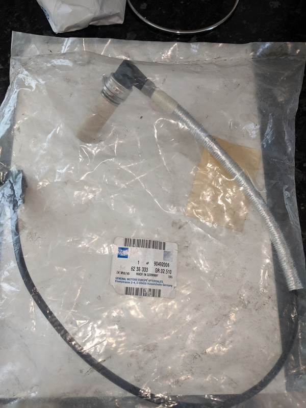

I've ordered a crank sensor which arrives on wednesday, I'll post an update after that is fitted. Thanks for all the help so far.  :)
Somebody didn't check the parts for sale,  Hope it's a real sensor.
