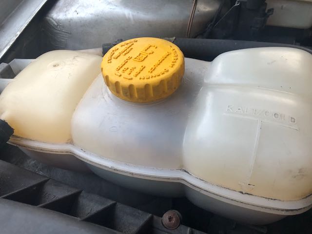

Starting to think again it's expansion tank, I checked tonight, found moisture around the rim of the cap at the bottom.
Top of the tank is showing signs of the dye.... (before this tank was clear all over, with nice red GM coolant) the dye has affected the colour.
Again, bubbling sounds around cap, if my ear is close.
