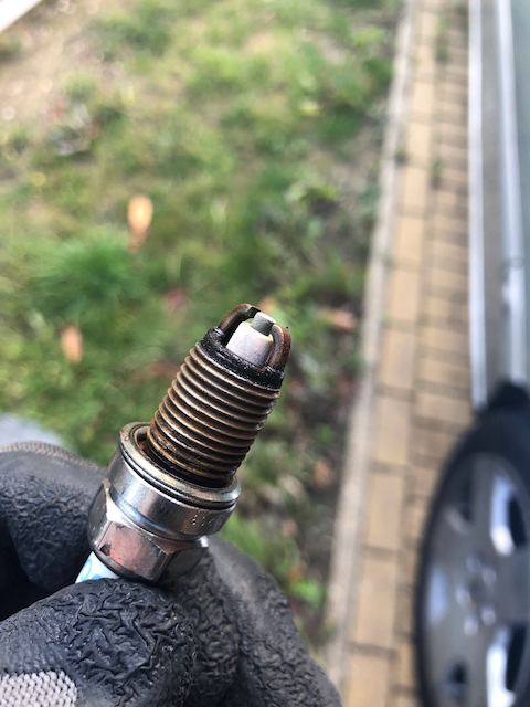

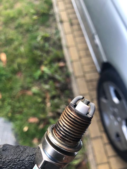

Coil pack boots fine...
Pot5 plug...

« Reply #6 on: 12 August 2019, 10:58:41 »
Possibly wiring, esp if disturbed recently for hbv work*. but are these the plugs you changed last week  :-\
Also pic of coil pack is largely useless...
Need to see the condition of the metal plates... Visible through the slots on the underside. Any hint of corrosion and they're on borrowed time.
Plug thread also looks rusty so probably a sign of water ingress, most likely scuttle related. After all, it's not like there's been any rain lately.
* For the record, I am not suggesting that anything Serek might have done has caused this, but the 3.2s do get hot and the loom may well be starting to go brittle, especially if it hasn't been disturbed for a while :-\
It wouldn't be the first 3.2 loom I have had to change for a persistent misfire.

« Reply #8 on: 12 August 2019, 11:12:42 »
Plug thread looks to be oily (not rusty) to me :-\
Plug looks like it has been steam cleaned to me - but I would want to compare it with the other two plugs on that bank before fitting new head gasket(s).
I know that the 3.2 head gaskets *never* fail but the youngest Omega is now 16 years old. (also Tunnie used to be a demon anti freeze flusher but I bet it has been more than 4 years since he last changed the antifreeze on this one)
