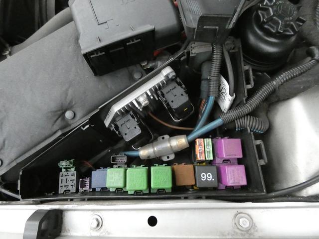

I cannot get the auxiliary fan to go to high speed through the test socket under the bonnet.
How is the high speed side of the auxiliary fan controlled?
What relay controls the auxiliary fan and what one controls the main fan?

Small blue one and green next to it iirc ;)
One of tother green ones is the aircon compressor clutch :y

Al, do you know what the open connector that is connected to the first green relay is?

Don’t recall seeing it on either of my Desmonds :-\

From memory, the front fan on a desmond does have the two speeds but there's a series resistor that drops some volts for the low speed, being that there aren't 2 motors to put in series.
Will see if I have wiring diagrams on this laptop to confirm...
