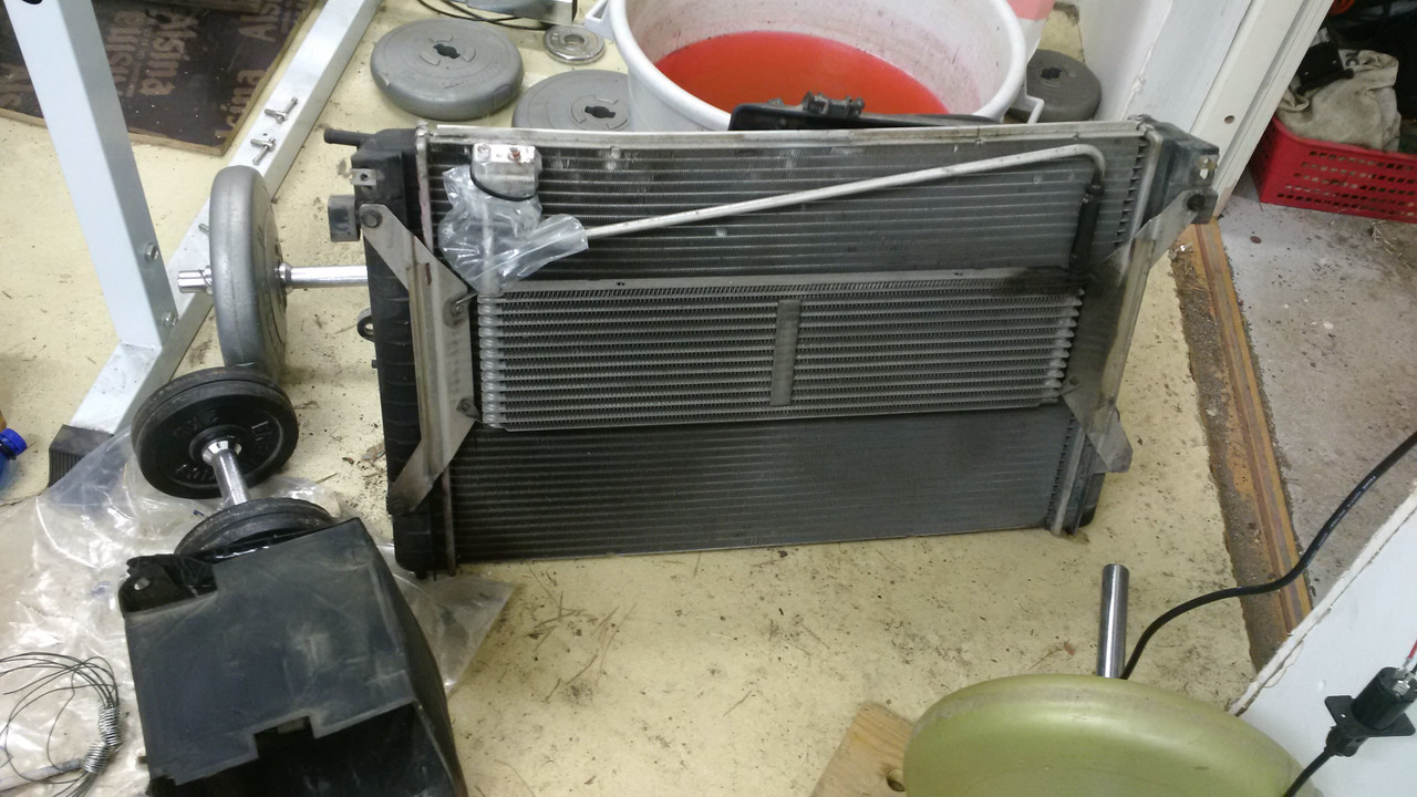

The metal pipes can simply be disconnected and tied back to the coolant bottle. As you lift the radiator etc out, undo the two screws attaching the condenser and leave it in the location. Once out, you can undo the four screws attaching the oil cooler to the radiator... Keep it upright and you won't lose a significant amount of transmission fluid  :y
...started finally to remove radiator. Does this above mean that I can remove the oil cooler pipes by unscrewing the Torx bolt above the oil cooler or do I have to remove the metal pipes from rubber hoses? Otherwise seems to be quite simple so far.

So I mean is it a risk to try to open bolt No. 3 after 20 years. Removing rubber pipes seems for me more complicated and might put some dirt into oil circulation, too?
undo the hoses as BG suggested; easier and less problematic. Wipe them clean first but you do that with every joint, don't you? ;)

All I ever did was undo #3 and lift #1 up and back and tie it to the header tank to hold it out of the way ;)
Keep the three radiators upright as you separate them and you won't lose any ATF. no point over complicating it.
Thanks DG, thats what I, However, decided to do, too.
1. Parts '2' O-rings are no more available, if not reusable does anyone know dimensions of them.
2. I have three fans; two in front of condenser and the third behind radiator. I took this third one "up" with radiator. Could that have been left there down?

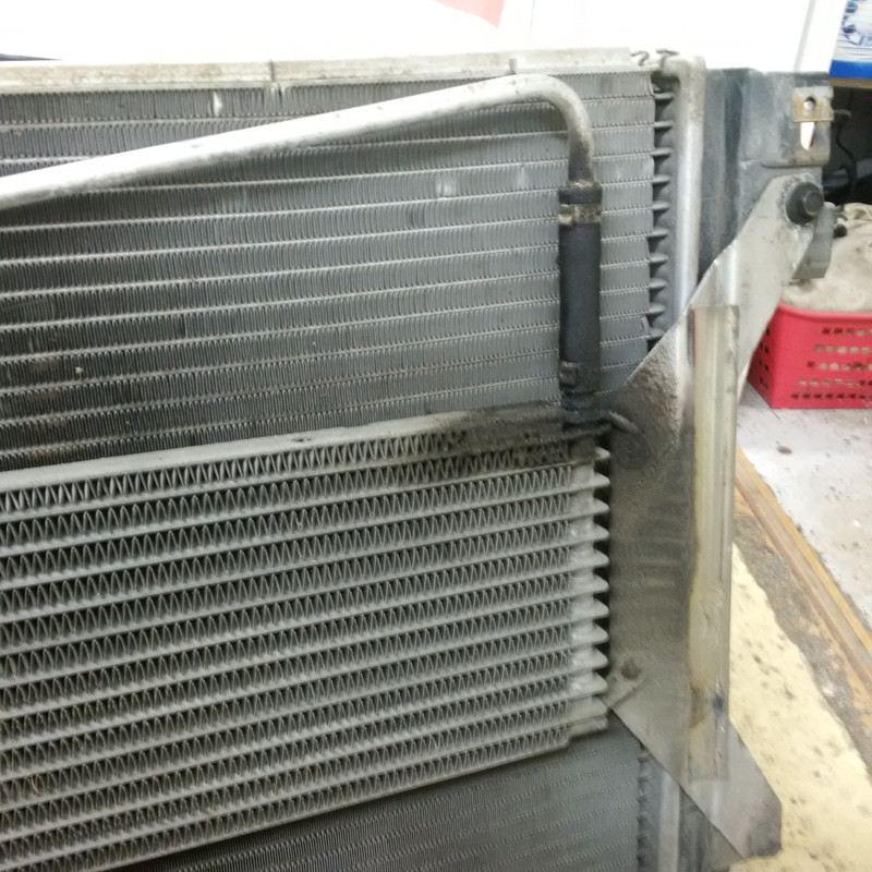

3. Looking at pics the rubber hose seems to be a bit "wet" in both ends. Is this normal looking, I have two options if not. Renew the rubber pipe or change the oil cooling to the built in cooler in new Nissens radiator. Then have to do some piping work, do you think worth doing?

I remove the bagpipes and rear fan before pulling the radiator... gives you a bit more wiggle room.
Not had an issue with O ring reuse.
Replace the hose, but be mindful that the aluminium pipe is fragile. Personally I would refit it as is.
