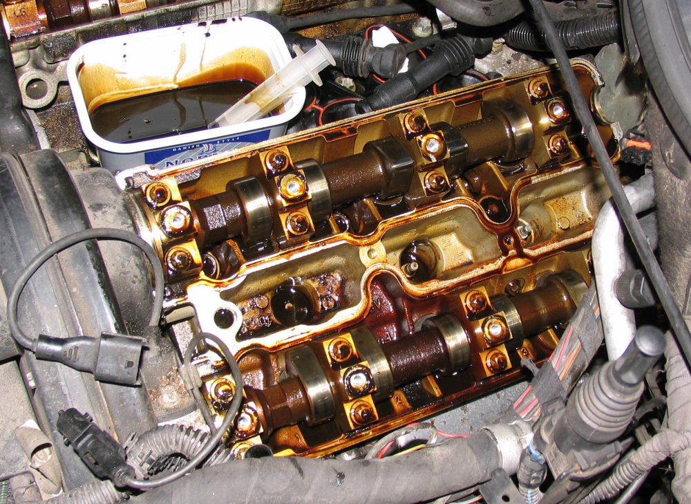

Tick Tock
  • Hereford
  • Posts: 666
    • 2.5 V6 Facelift Estate
Syringe with a bit of pipe on the end.
Omega 2.5 V6 Facelift Estate.
rds
  • Posts: 172
cheers Tick - that looks worse than mine but the last time i used the syringe and tube, it took ages.
RDS
RDS
use a better syringe 8)
