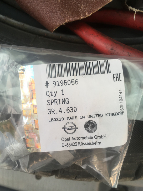

Well I can report that the spring retaining clips have arrived and very quickly too via Vauxhall dealers so that's one less problem and not too bad at £7 each
Before you fit it, check against this...
http://www.omegaowners.com/forum/index.php?topic=127928.msg1942220#new
Enceladus
  • London
  • Posts: 1109
Re: Rear Brakes
« Reply #100 on: 02 May 2020, 04:03:28 »
Might be wrong but in that thread there used to be a useful photo of the vented parts laid out on a sheet of graph paper. The photo seems to have gone AWOL.
Just in case.
GM #9195055 are the pad retaining pins for vented discs and are 86mm long. Pins for solid discs are 73.5mm.
GM #9195056 are the anti-rattle cross springs for vented discs and are 56mm across the horizontal span. Solid disc cross springs are 48mm across the horizontal span. And that's because although the pads are the same the vented disc is 20mm thick vs 12mm for the solid.
Also the vented disc calipers have Ø42mm pistons vs solid at Ø40mm. So they're not identical.

« Reply #103 on: 02 May 2020, 20:00:19 »
