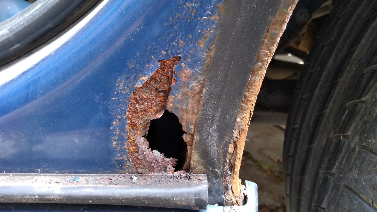

As far as I can see, this is the biggest rust isue. Floor looks good, only other rusty place is panel below spare tyre.
Rear bumper rod needs replacement. Exhaust seems ok but I sense some vibration on idle. Cant figure is it him or maybe engine mount or something else.

You've not taken the plastic sill/cill covers off yet then  :-\
 i'd expect rust looking at the rust you found so far

Looks familiar, this
wasn't the problem, because it was hiding this:
and the holes in the sill were visible from the inside, without removing the cover. The other side was only better because there wasn't the hole in the door shut.
You might want to unclip the bumper and examine what's left of the wheelarch under it:

I'll start with plastic removal tomorrow, then we'll see are there any surprises..
I dont find this tragic for 18 Years old car. I had bigger rust issues two years ago with 2004 X type Estate imported from Holland..

« Reply #10 on: 30 September 2020, 11:21:39 »
Thanks pal!
As you predicted, this is inside look through that rust hole
Other side look's a lot better:
After removing side skirts I found another rusty place
This is passenger side corner near jack mounting point.
