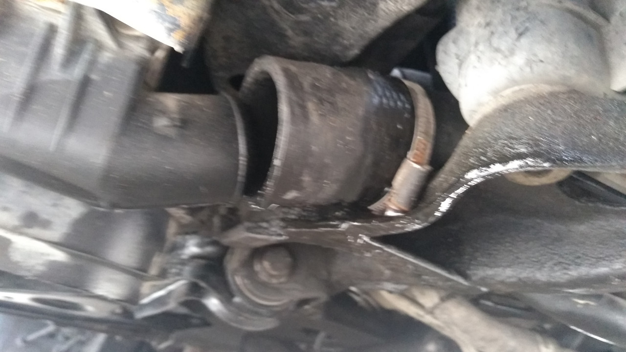

Some (not so) good news about Omega.
In past weeks I'we changed oil, filters, both V belts, rollers, tensioners, front right engine mount, front arms, and faulty Turbo hose clamp.
I still feel some vibrations caused probably by small rear mounts under the transmission.
Couple days ago, while sitting on the traffic light, car suddenly staled, and I couldn't start it again. Towed her back, changed everything possible from donor car, cranck sensor, cam sensor, both fuel pumps, ECU, checked fuel lines, checked if there is pressure on fuel rail, there are no faults on "My Naff Code Reader", check engine doesn't light. I looked if the small chain isn't snapped, and everything looks ok.
She cranks normally but no start.
I lost ideas ( and energy) to figure  out what could be the problem . Guess I'll wait my repair guy to come back from holliday  :'(
