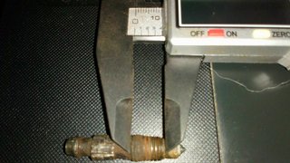

Would any body have the exact length of bleed valve that I am looking for? Found different lengths in M8x1.25.
Found this one. Is it correct size length of threads? Just the length of threads on the one from the caliper are 10mm. Overall length is 38mm. Only the last 3mm of thread was inside the bleed hole. Does this sound like the proper factory fitted one? Reason asking is that the outer piston seal is in good condition, but the actual piston is pitted.

addy
The bleed valve from the caliper. I chewed it up getting it out.
