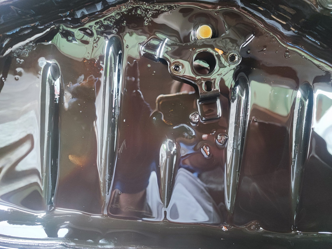

I got the oil pan off...there is no glitter or any residue. I've found two small metal pieces in the sump and one in pick up strainer. Pics follow
