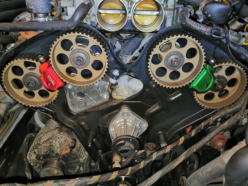

Timing belt, it was clearly TIME TO CHANGE!!! (this one was at least 12 years old and more than 80.000kms)

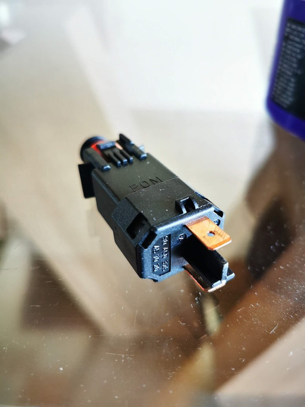

Stop switch, that little thing was worn inside, and never went back to its normal position. New one fixed all the issue linked to it.

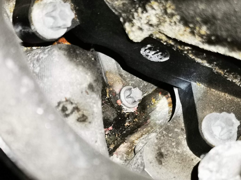

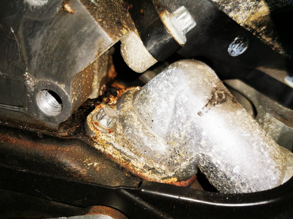

While working on the timing belt, I checked the cooling system and I think it needs to be fixed as well. Too much coolant build up in this area...

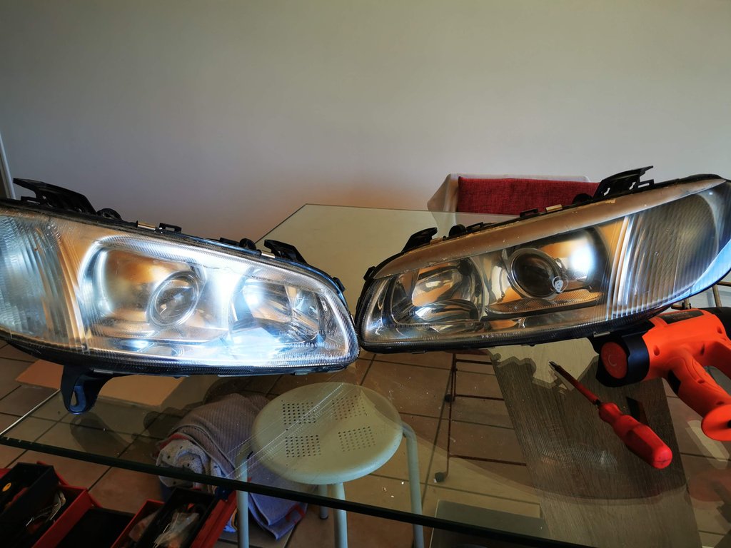

I bought a pair of '98 headlights without xenon. The goal here, totally refurbish the units and properly fit bi-led lenses. Something I already did on my Calibra and the result is astonishing.
For now they are waiting, I need to make the spacer for the new bi-led lens.

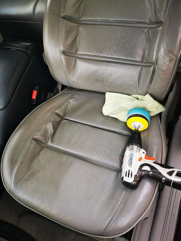

Talking about cleaning now, first time with leather seats, first time with clear leather. I just took a medium polishing pad with a soft leather cleaner, cleaned gently and the result is perfect!

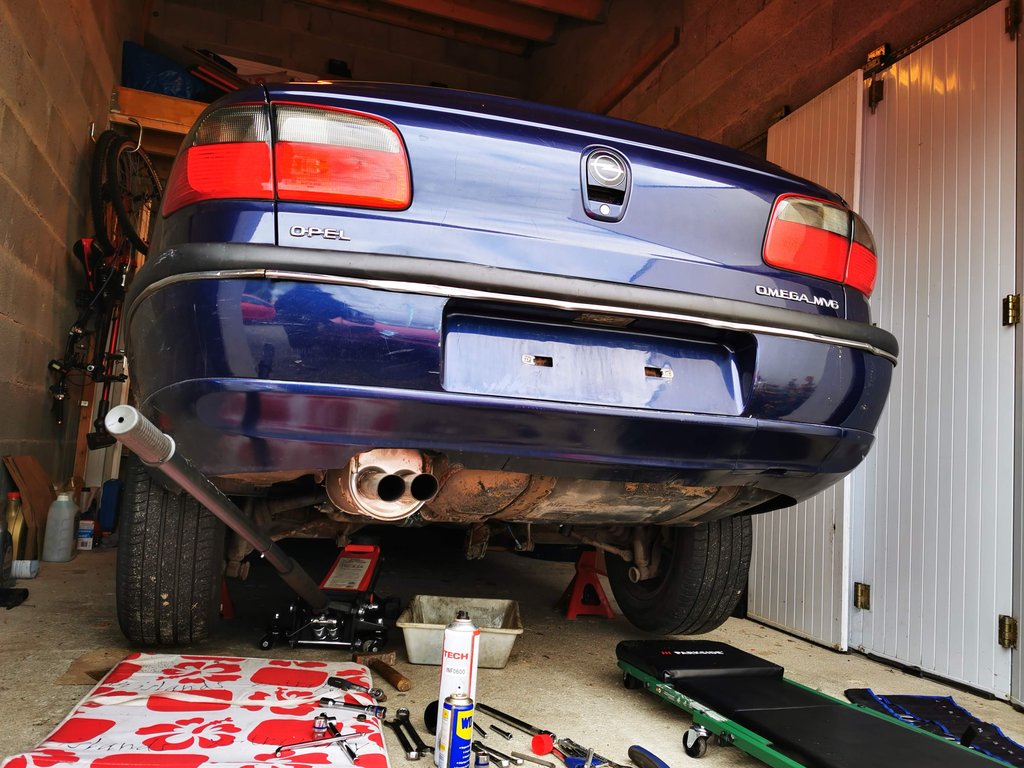

They were stuck, a good heat gun focused on the out cylinder of the disc and a good hammer + WD-40 eventually had them
Grease on the lip only (M539 Restorations best advice), brand new ATE discs and Brembo pads.
I replaced the complete tie rods because it was impossible to move the previous ones, even with WD-40, heat, vice grips... Easy task, and this is Moog parts
