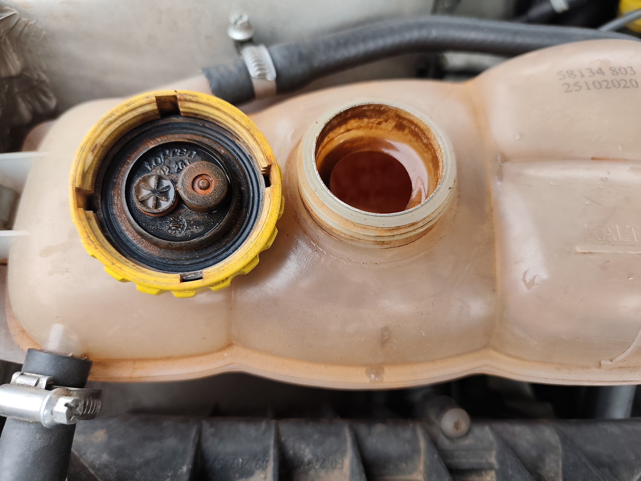

A bit of update on this guys, I've found coolant bottle almost empty, had to add a liter in. No obvious leak anywhere, but coolant bottle is stained all around the edge with red/brown residue, like the cap was bad. Car has no heating anymore, front vents blow luke warm air and cold from back vents. Omega doesn't overheat and the temp gauge still behaves as in video uploaded months ago.
And head gaskets were done a year and a half ago.
Any ideas?

I'll need to check for oil in coolant then....by look it seems there's only some rust residue
  • Posts: 108339
Re: Thermostat stuck open maybe?
« Reply #9 on: 10 April 2026, 20:14:00 »
Ah, Ok, wasn't that clear from the photo.
Rusty coolant can only really be poor servicing I'm afraid, not using a strong enough coolant mix, or not changing it at correct intervals.  That doesn't explain where its leaking/disappearing to though.

I can't talk for previous owners but it had coolant replaced 3 times since I bought it with 50/50 mixture. It seems like it's leaking from coolant bottle cap, since it's stained on the outside. Would oil cooler leak make pressure build up? And how is poor heating connected with this?

Yes, cap was replaced. I had pressure build up in hoses with old one. And the result with new one can be seen on pic....Could failed oil cooler be the culprit for pressure?
In a word, no.
