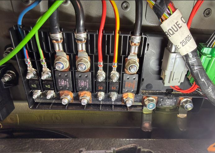

In HVAC, got a B11ED-87 Electric Heater Control Module
Is that an axe PTC heater to help warm cabin until engine warms?  Looks too much of a bugger to change if that has gone faulty.
Schems show it's powered via a 150A fuse, but I can't find a 150A in the usual fuseboxes?  Schems are Part 2 under HVAC in Topix's wiring diagrams.  Any idea where this fuse could be, as worth checking before going further?

Stumbled across this:
The source was Jaginfo.org
‘The megafuse is in the battery junction box in the boot on later cars. It’s 150 amps.’
No idea if it applies to yours or not.  :-\

It’s a bolt in fuse, apparently in the trunk side BJB, not a normal blade type.  :y  That info was in reference to the XJ X351, so you probably know all of this.  ::)
Schematics shows Battery, to Battery Junction Box (150A Fuse) , PTC + going to Heater Electric Booster.
« Last Edit: 07 April 2026, 23:12:16 by YZ250 »

Yup, cheers YZ, thats what I'd found in the schematics, but it doesn't say where it is.  I'm making an assumption that a Battery Junction Box is near the battery, much like the fusebox on to of the battery's +ve terminal on an Omega.  XJ has nothing like that, and the access panels in the trim in the boot only give access to microblade type fuses.
Yes, I’d agree with your assumption that you should be able to just follow the battery +ve lead to the closed cover junction box close by.  :-\

Found it (I think)
The 150A fuse has 12V both sides, so assume it's OK?

« Reply #10 on: 09 April 2026, 00:30:46 »
Have you got a current clamp meter?
That would tell you if it's working.

I'll have to get it back of Gixer, though not sure if it did DC.
I was kinda just trying to sort all the niggles out, making sure everything worked, and had got to the point of going through the faultcodes.  If this was an easy fix, then I'd do it just so everything is working. If it needs that heating element replaced, I'll wear a jacket for the first 2 or 3 miles ;D
