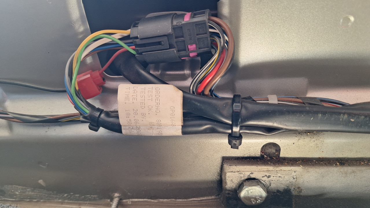

This is what I found from my boot. I red somewhere below that the red wire is hot coming from fuse 29. So I perhaps need some kind of plug as DG informed. Hope he is coming home soon...

Measured red one from vehicle harness side. It is 12V, Towbar side is empty. I took fuse 29 away and rew wire is still 12V. So it is coming somewhere else than No. 29, top row fourth from right. Any idea where it is coming?

Found it, Fuse No. 5. Front seats adjustment.
