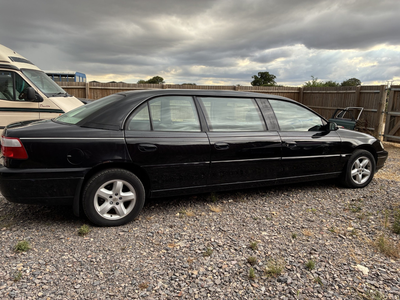

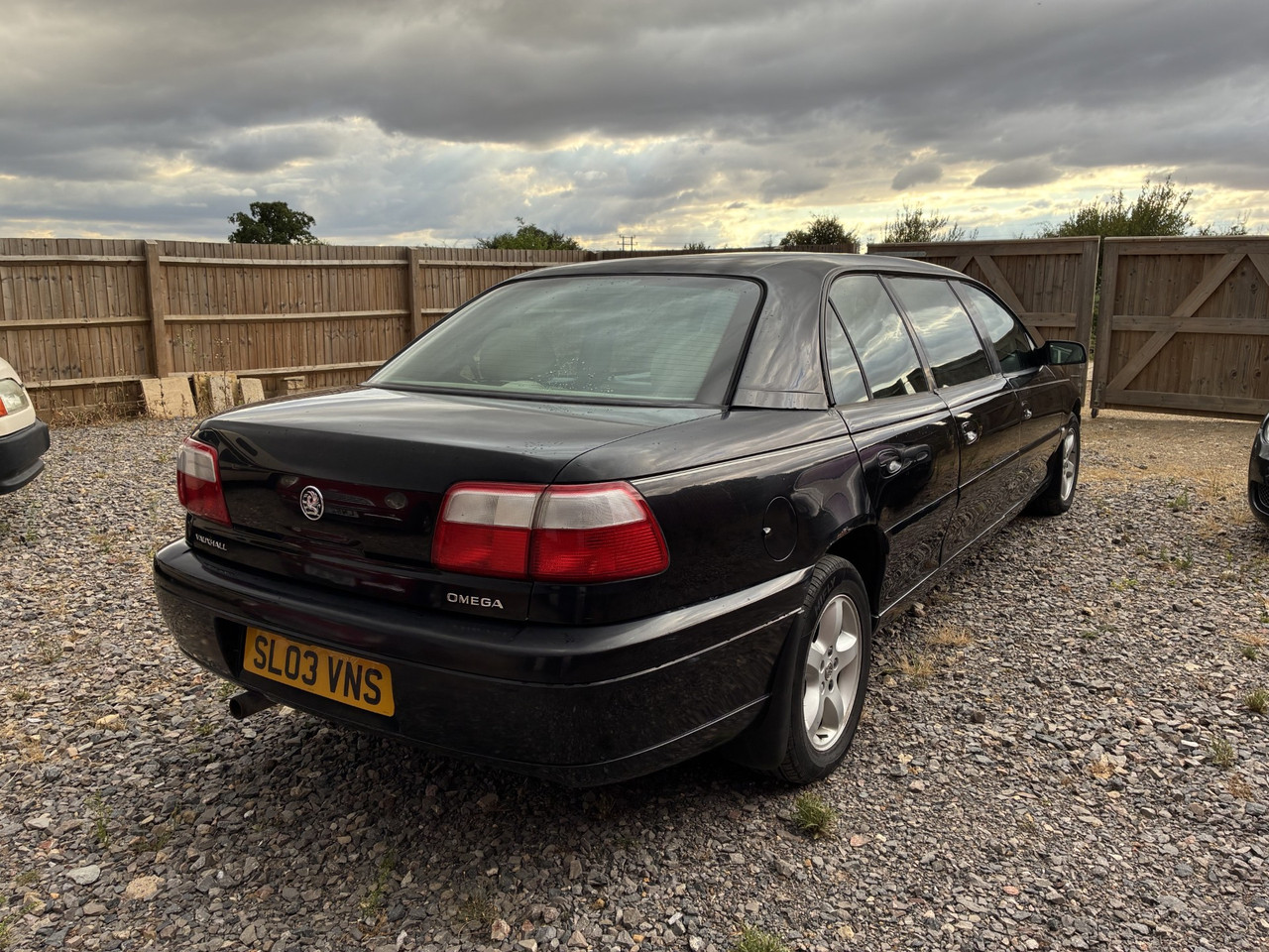

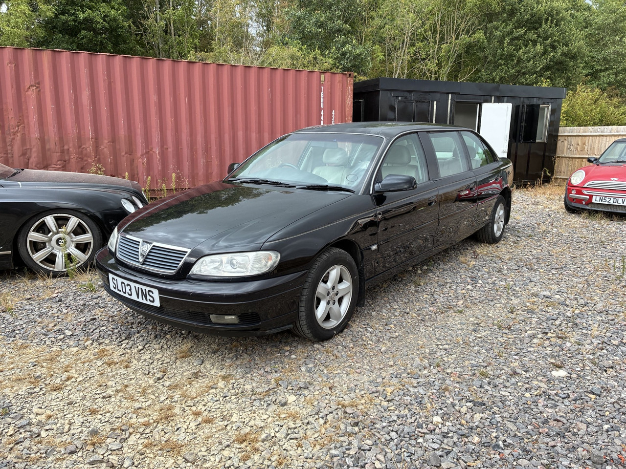

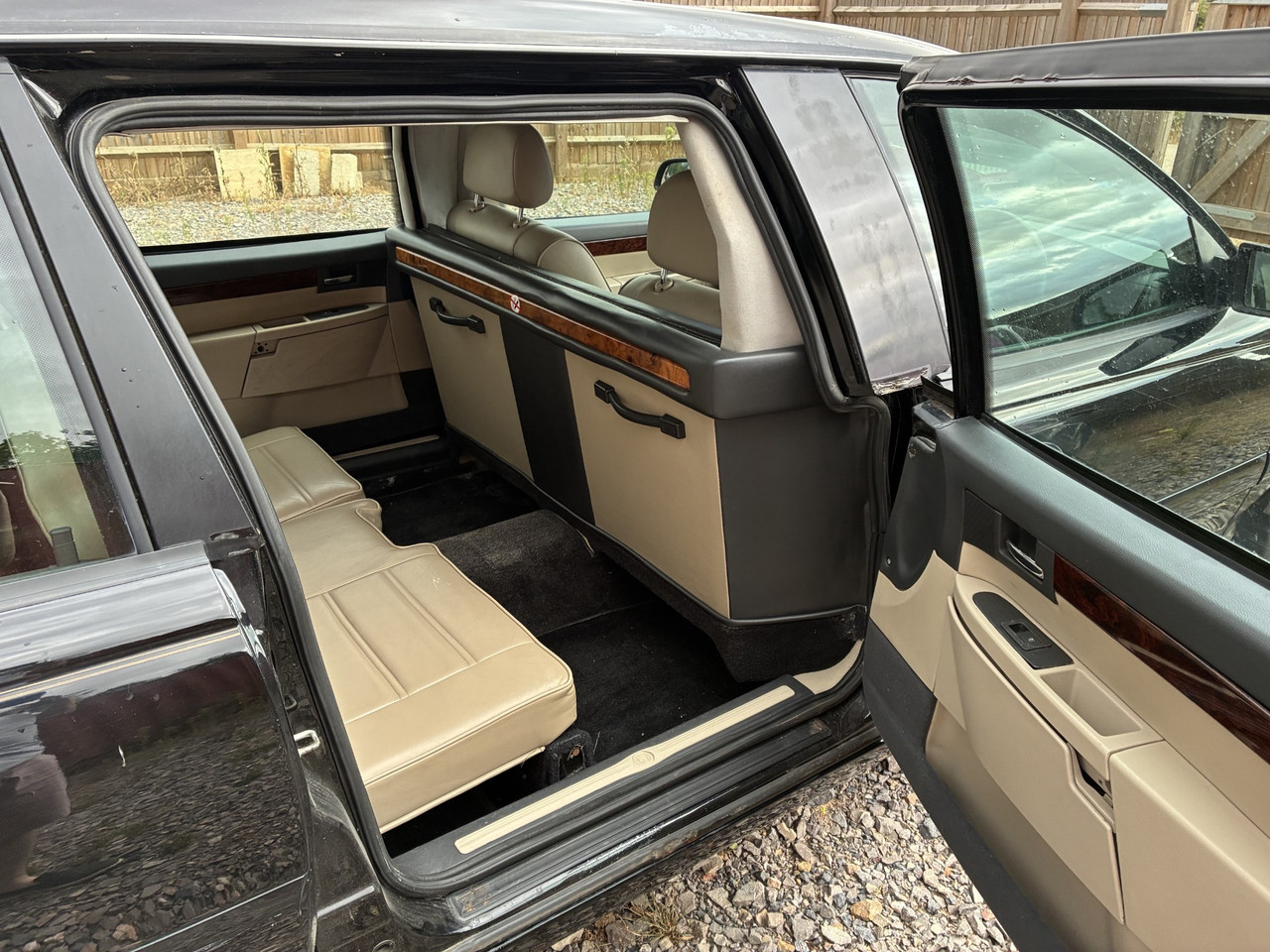

...this is the perfect example!
it was converted by Coway when new, from a 2.6 CD spec saloon. VXL V6 will kindly sort me out with the parts I need to make it Elite spec. This is the first Omega I've driven with Halogen lights!
Upgrade to Xenon and headlight washers, rear view dimming mirror, late Elite wheels and boot spoiler, and park pilot.
Two questions which I will post in the correct section  ;D it's been such a long time I can't remember how easy it would be to ditch the CDR 2005 and upgrade to NCDC and GID / CID and the 179bhp is fine in a standard saloon, but I seem to remember you can use different cams in the 2.6 for more power? An extra 10bhp would help.
If anyone wants to live out the dream in 8 seat comfort, you're welcome to stop by for a go in it!
