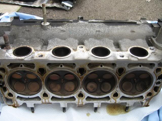

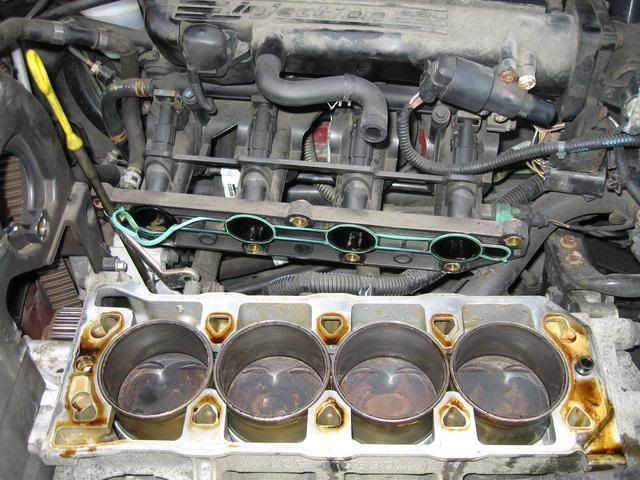

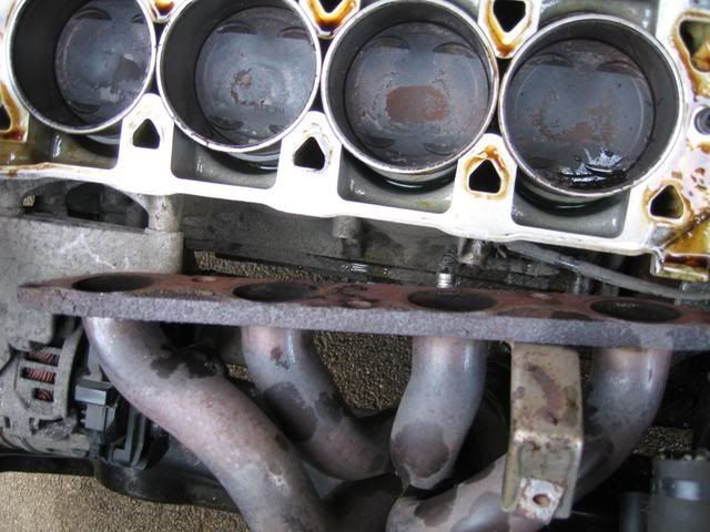

Yep, I think you can safely say the headgasket is  :-Xed!
To be honest those pistons don't look great either. What is going on in no.4 cylinder?
Oh, and is there a reason for leaving the plugs in? Just curious....

Look ok to me....pretty standard state after headgasket failure (signs of rusty water etc).
So, who can see the fundamental design fault that causes it......
Bit of coolant dropped in no4 when head came off and photo tqaken...
The badge on the back? ;)

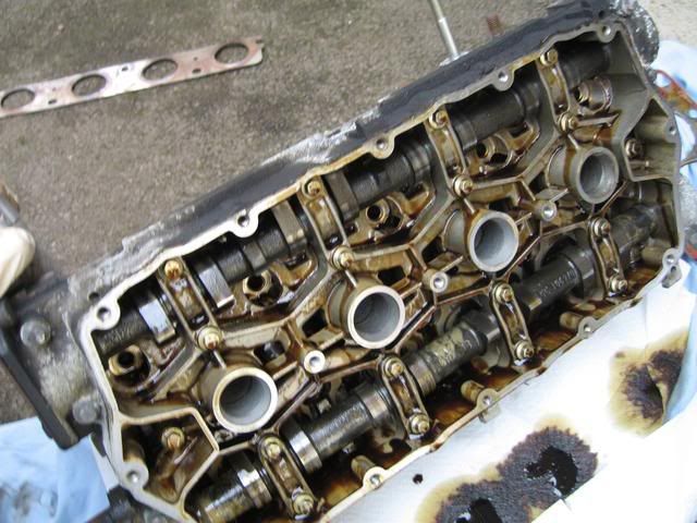

Wheres the pic of the old gasket....

Too big a bore so too small a contact area around liner and head.
Designed as a 1.4

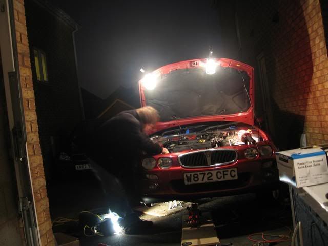

Still at it...
