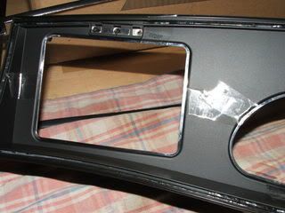

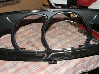

After trying yesterday to no avail, managing to pick up a spare dash & housing from Max today to play with, the results in pics below;
After removing the plastic housing face, by prizing with a flathead screwdriver, unfortunately as it has been glued in place some bits cracked off, had to just take time prizing a little bit at a time, and be careful on the corner sections. Before you attempt to remove the housing face you have to remove the plastic beading that runs along the top and bottom of the housing.
The chrome surrounds sit in the sloping sections of the dial surrounds, it is better to tape the the chrome surrounds in place. Then superglue the surrounds in place from the back of the housing.

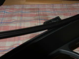

Picture not very good but this is the plastic beading, it is better to put this back in place before putting the housing face back on, the housing face needs to be glued back in place.

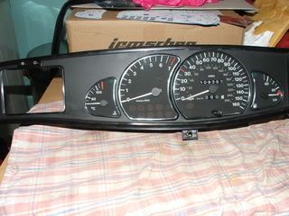

Completed with normal dials.

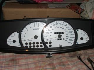

Completed with white dials. However, there is a hole missing on the speedo dial for the fog lights, and the dial unti will not clip fully back into housing on 1 clip. I hope to overcome this this afternoon (Monday).

errr....   let's hope it fits then.......    I think i would have held off the superglue until the real thing though... just tape would surely have been enough proof of concept......   as your glazing panel will be cleaner and nicer being several years younger than mine...
